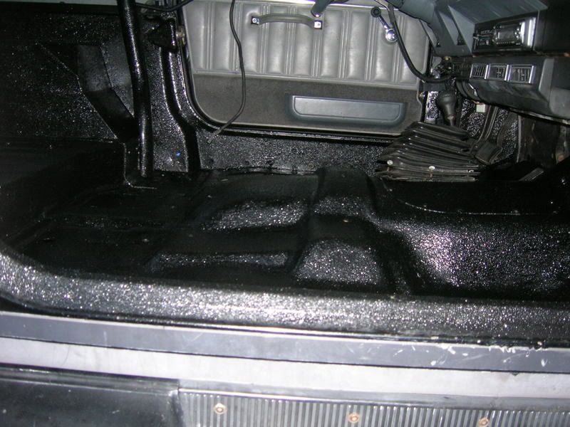

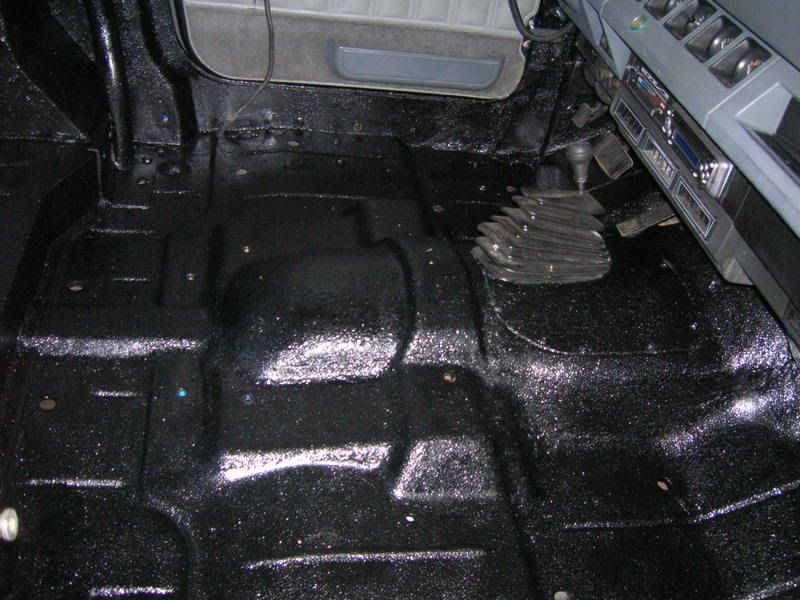

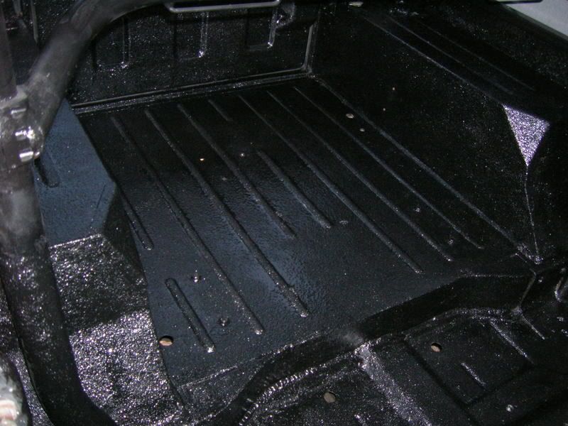

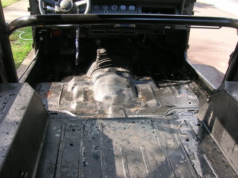

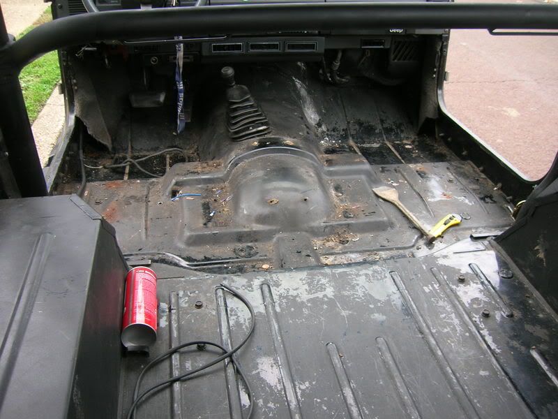

hey i did my interior was really easy rolling it on i used durabak bedliner..the only thing was the prep work took forever..i did about 8 or 9 hours of prepwork over 2 or 3 days...its alot of sanding to prep it...and it took a while to get of the glue on the back of the velcrow...but it was all worth it...its all in the prepwork tho that makes the difference here is what mine looks like b4 and after
