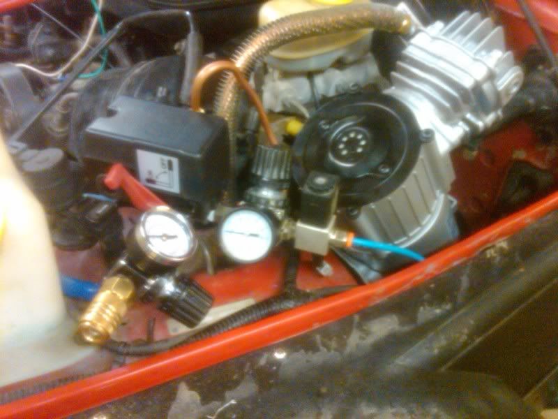

I run the same compressor as Knucklehead, you will not find a better/comparable compressor for anywhere near the cost. I have mine hard mounted under the hood and run my rear ARB with a simple air compressor regulator set for 95 psi.

I did some extra plumbing to fit my needs...

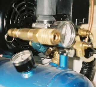

Those puma setups look like good systems. Are those the 1 gal tanks? and are those AC or DC?

12 volt dc 1.5gal tank with an unloader valve.
