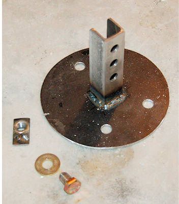

Here's one that is inexpensive to make:
In these photos it is used with the stock tire carrier and a Gr8Tops Exogate tailgate reinforcement, but the same idea should work with your tire carrier - the "mounting stud" part of it (photo just above) just slips over the studs for mounting the spare and is sandwiched in between the spare and the carrier.
