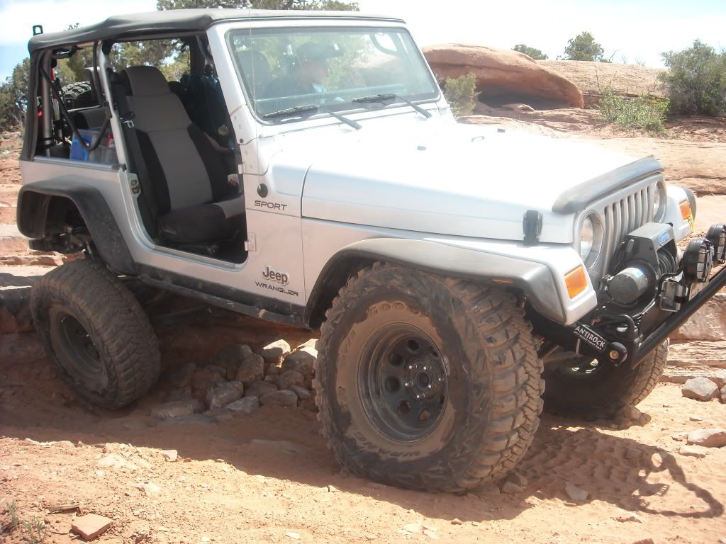

AntiRock. I have them front and rear. I live in the Colorado Rockies and most of the roads (actual paved roads) in my area are winding, curvy, mountain roads. I have no complaints. The Jeep is not a Porsche.
I have my front set to the loosest setting. You can always choose to run the front in the stiffest setting if you want.
My junk flexes just as much as it did when I had disco's.
...and because every thread needs a pic
