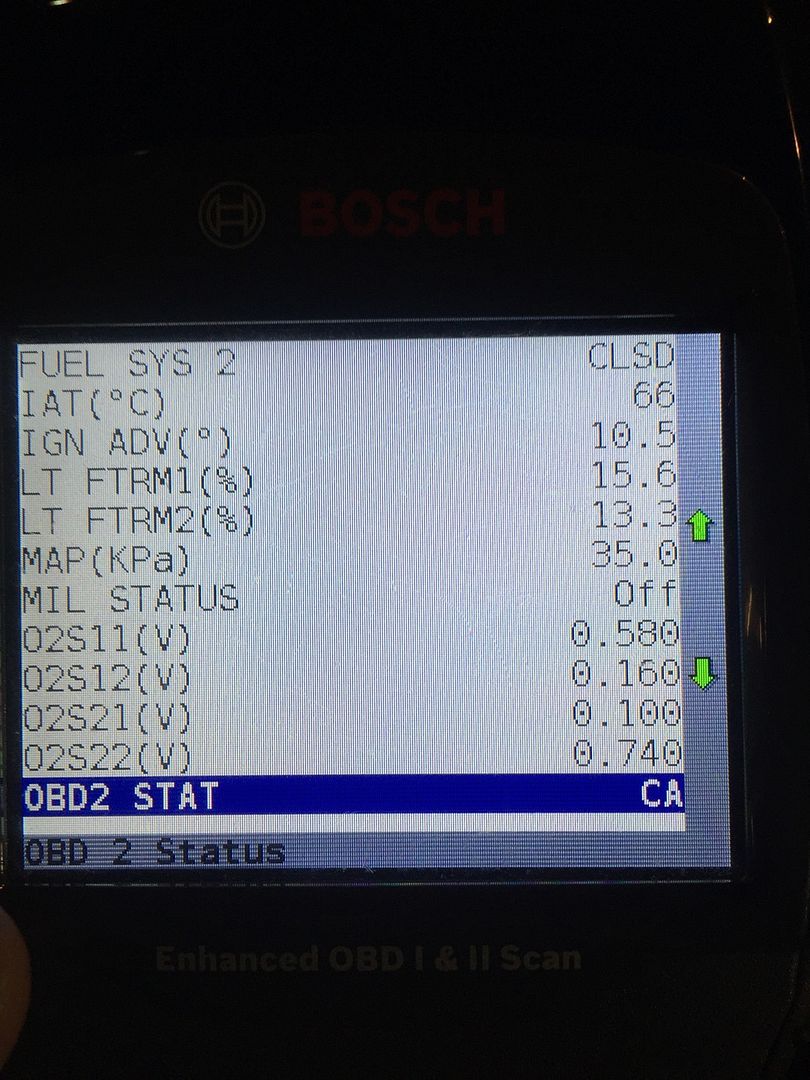

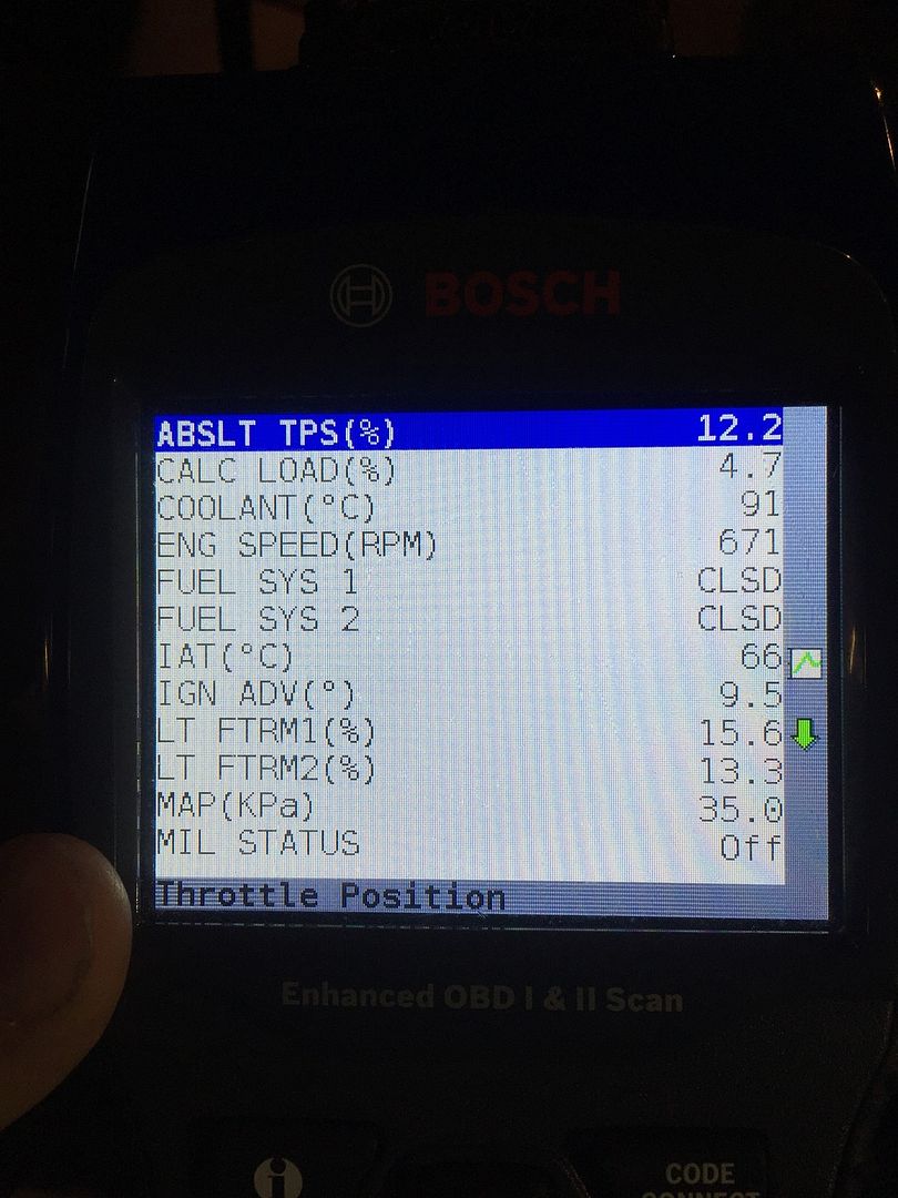

Here are some screenshots of the datastream of my TJ just prior to replacing my thermostat and oxygen sensors. (i replaced the t-stat because the temp would never get above 195. I bought a new thermostat from the dealer and filled the system with the correct coolant and now it runs at 210 like its supposed to) For those that are more familiar with the TJ operating parameters does anyone see any value that is abnormal?

The only other thing i can think of at this point is the coil rail is going bad? I also forgot to mention my engine ticks... i can't seem to track down where its coming from though.

Posts: 404
I am of no use here, however if you get oem parameters and compare to those it should highlight your problem.
