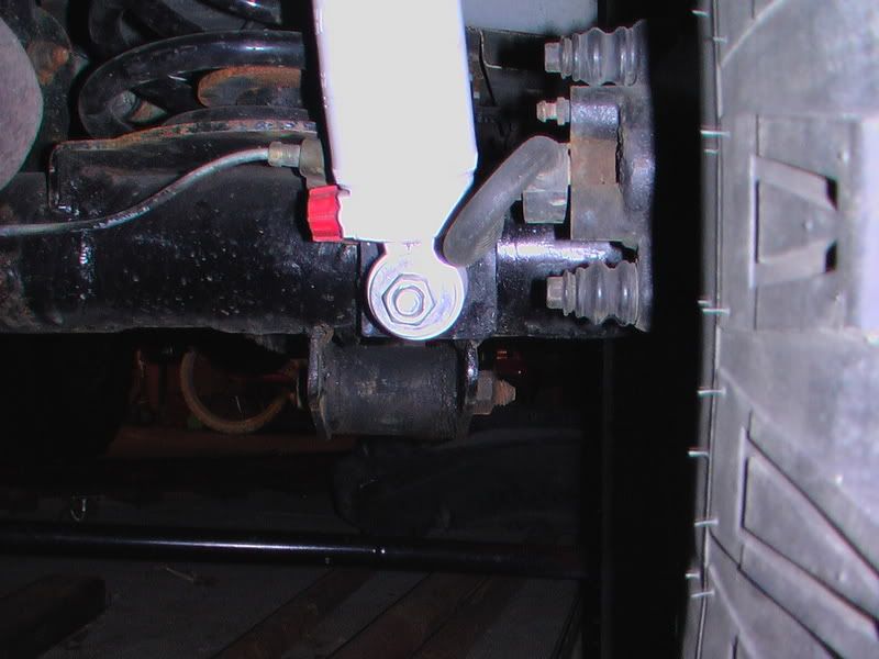

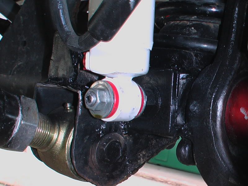

I take it you fabricated the front and rear shock mounts? Some pics of the rear shock setup would be nice.
You've got a great rig.
Originally Posted by MrNate View Post
Are you insane? Do you have any idea how many slip-and-fall accidents are caused by carelessly discarded banana peels? This is a crime of Vaudevillian proportions and must not be tolerated in a civilized society.
Originally Posted by RyanCJ2A View Post
I have no input of any value to this thread but those are awesome.
pmccoy9876 is offline
post #43 of 70 Old 04-08-2009, 10:09 AM Thread Starter
White99tj
Location: KC
Posts: 69
The shock mounts are the ford shock towers front and rear.
The shock mounts at the axle is just some channel iron with a hole drilled for the shock stud. I also added a 1/4" square washer to give the shock mounting surface more thickness.
I trimmed above the control arm for more clearance.
Front
REAR
White99tj is offline
