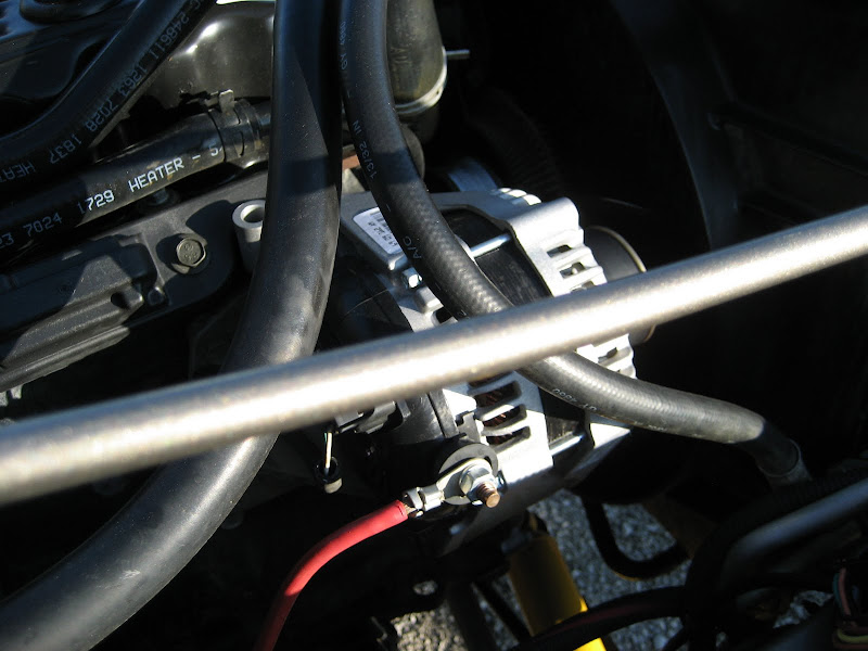

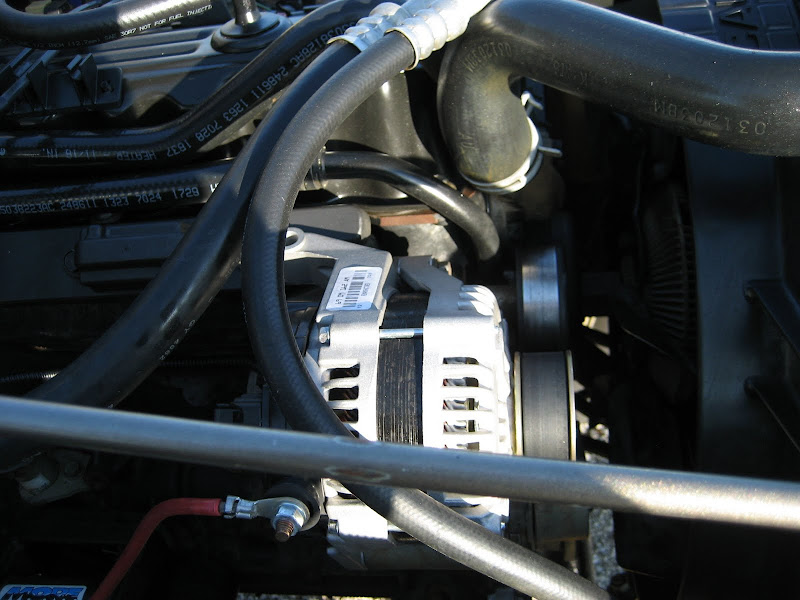

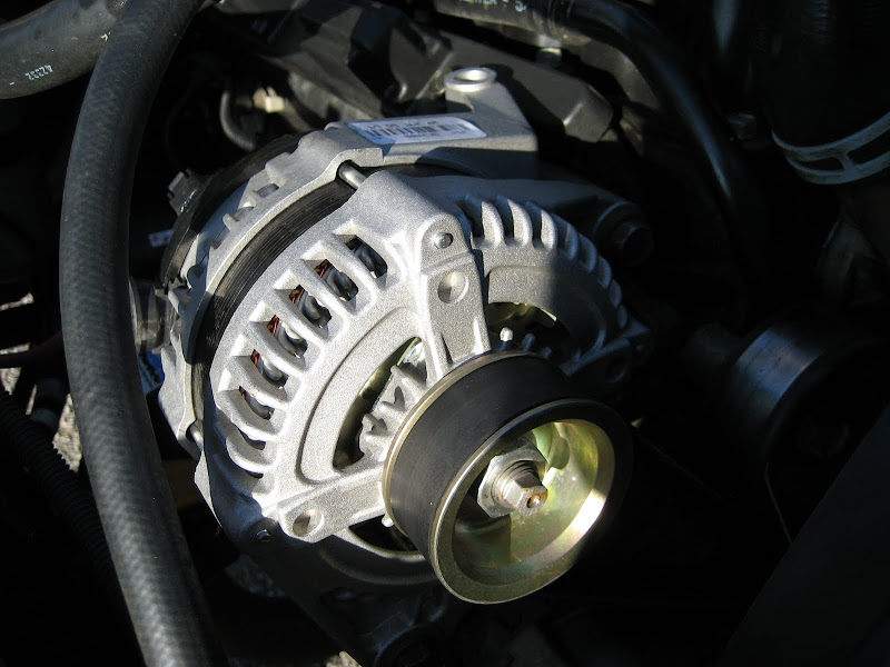

OK.Just found a alt from a 98 Dakota with a 5.2. All connectors are the same and a little research reveals it to be a 136 amp. I'm going to swap it in after this damn rain storm. Wish me luck.

It lives!!! All I had to do was press the bushing out a little and swap the cable gaurds. Easy.
