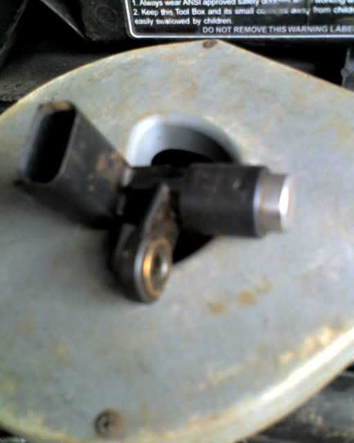

some look like this one off of my 03 auto tranny, located just above the starter.
wasn't even bad, the contact on the flexplate was coated with mud.
