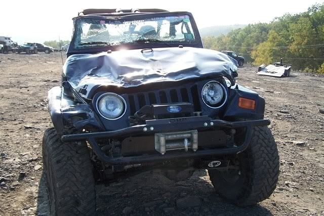

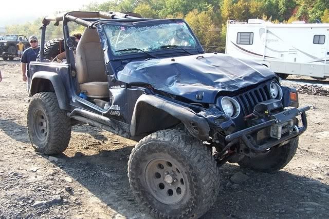

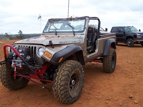

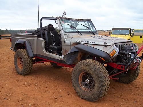

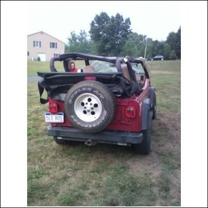

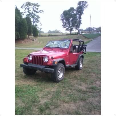

Why These Cages Are So Important
After Math
looks like the cage did its job....

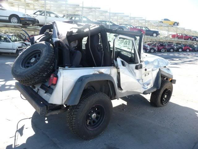

AEV Brute:
Another Rockhard

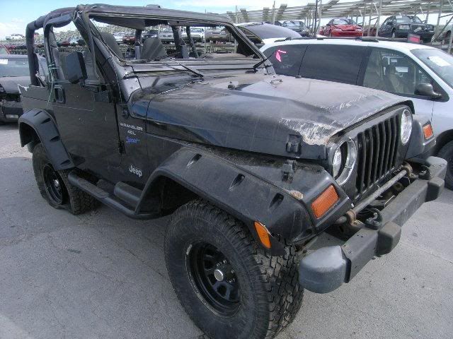

Something similar to Poison Spyder Customs:

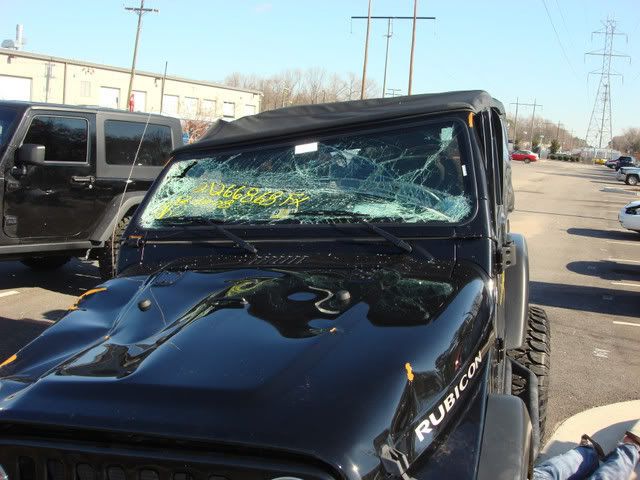

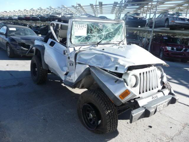

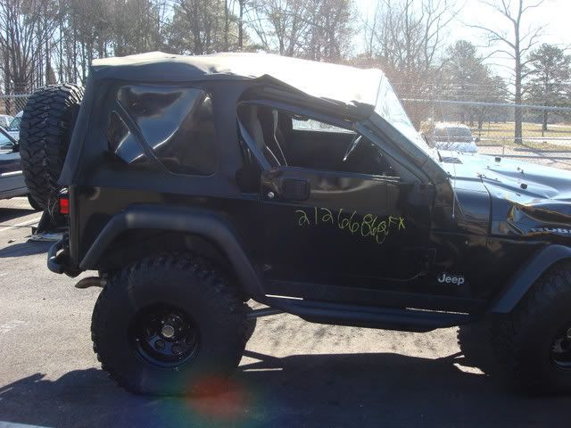

Stockers showing the windshield vulnerability:
