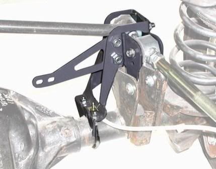

both are... I might have a couple nth brackets, if not, you can buy direct..
the part number is on the box in the pic.
