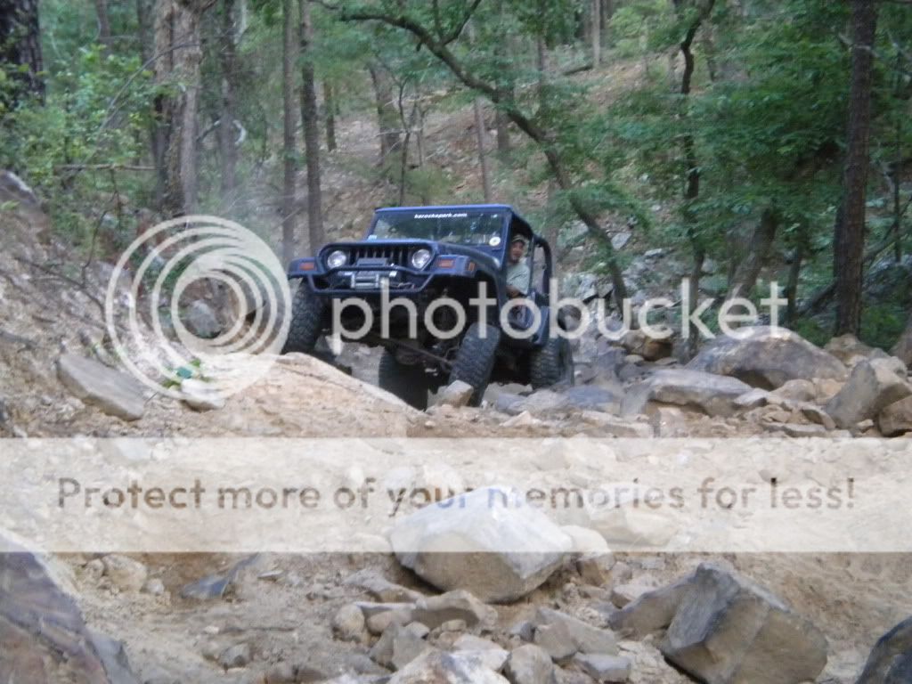

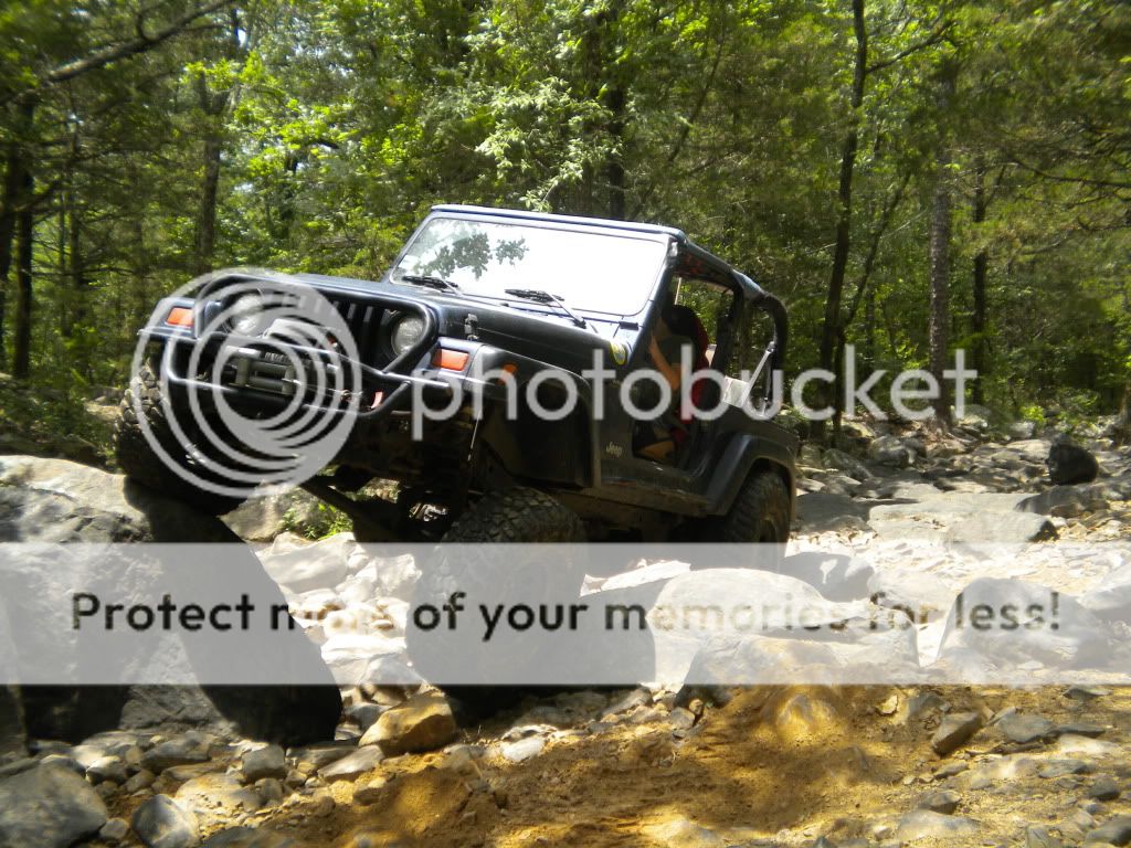

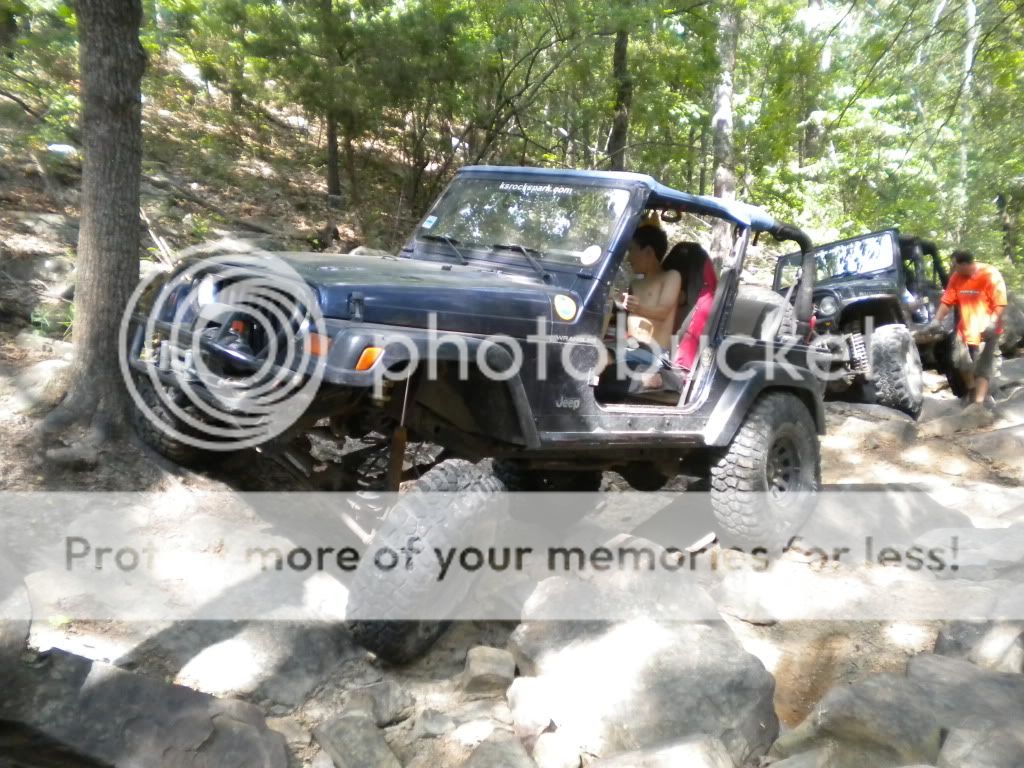

I run the setup with Rubicon Unlimited coils on my 4bngr TJ. I also run a 1.25"BL on 35" KM2s. Make sure you have articulating arms and track bars as well as long travel shocks with properly sized bump stops/extensions.
July 4th weekend in Clayton, OK in Green Acres.
a little high centered

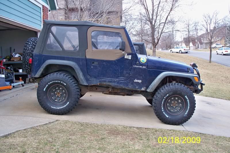

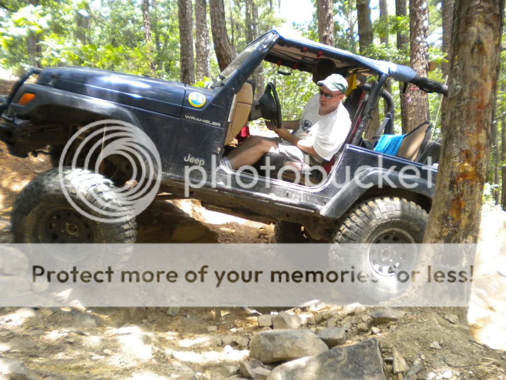

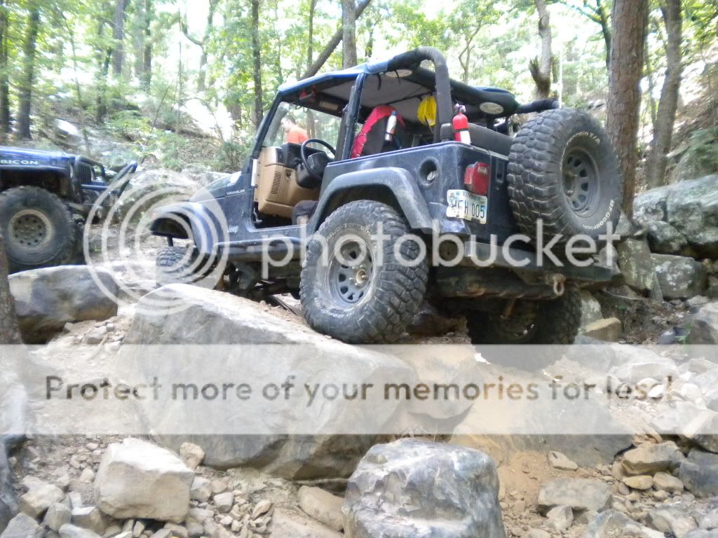

This was before my jump to 37s.
