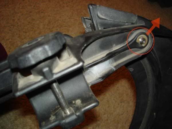

Shouldn't hurt anything really if it's the original top it's probably pretty
loose from years of sun and wind..... Your plastic "door surround" the two
piece frame your soft-top grips onto around your door can be disconnected
into two pieces when you're either running the "canopy" or a "safari top"
and you can just run with the top piece of the door surround leaving your
sides more open..... there's a little "c clip" that holds the hinge together...
just pop it of with some pliers and get even more open air.....
