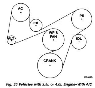

Possibly the wrong belt or incorrect belt routing.
The belt routing should like like this for your Jeep.

Okay so 92.3" doesn't work either. It's routed the same as the diagram. Soo..... I guess I will take it to the auto parts store and just change belts till I find the right one. I just can't figure out why it would be an odd size.
