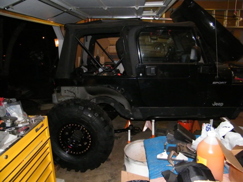

6" is definitely WAY too much.
here is 4.5" on 40" tires:
I WILL be adding a 1" BL, but it's only for a 1" MML to clear the driveshaft up front and to get a flat skidplate under the belly.
SOLDThe lumbering steel-laden pig - 2003 TJ - 40" LTBs - D60/D70HD - 5.86s - Detroit lockers - 110" wheelbase
