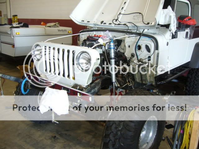

sorry... couldnt find the camera.... got lost in the bench top jungle!!!! found it... more pics tomorrow or today for us on the vampire squad.

recoil and bennettj.... so hmmmmm.... how are you supposed to fit a 9/16th bolt through a 1/2 hole or even one thats a 32nd too small...... they should just supply you with a 9/16 drill bit seeing that you have to go over darn near every hole and im not talking about the layer of powder coat either.
i did weld the rear bungs in last night, fit the rear lowers in. started on the front. put the d44 back together so i could roll it under the jeep for mock ups.
messed around with the shock hoop placement. as of right now i think i have a good spot. also it work out that i can weld tabs to the hoops and mount the steering bearing supports. im going to end up going hydro. the steering shaft-to clear the header- has to run horizontal along the top/side of the header, then into another ujoint, short shaft to the valve unit.
thinking about taking some 1" tube and spare heims; and making a set of 'coil jigs' to help mock up and then 'set' the front at ride height.

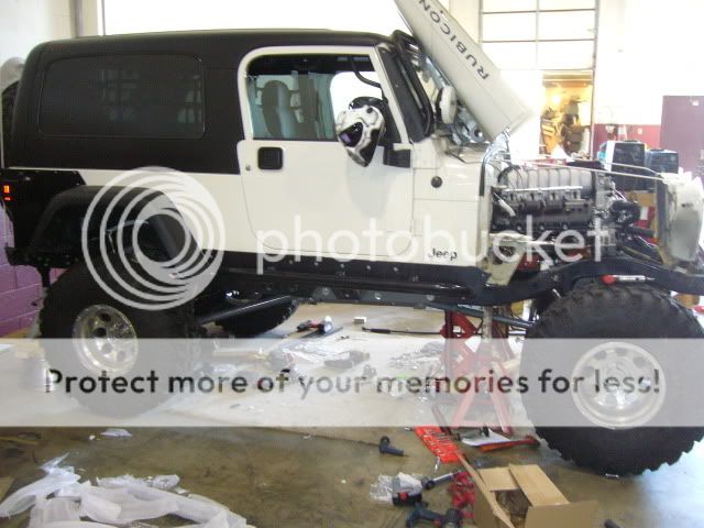

ok just a few teaser pics..... for now
with a digital level, the frame side to side is 0.1* level. the bottom of the oil pan is 0.1* level..... strictly luck......
