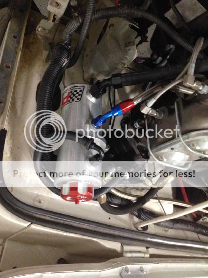

finally got the trans pan installed with the trans 'temp' sender in place. had to re-tap one hole as it appears 'someone' stripped out the threads. hmmm.. I know it wasn't me. anyways, grabbed a 7mmx1.00 and cut some new threads, a $0.50 bolt and away we go. added a few quarts of aft+4, thanks Chrysler, to check for any leaks/seepage. all good so far.

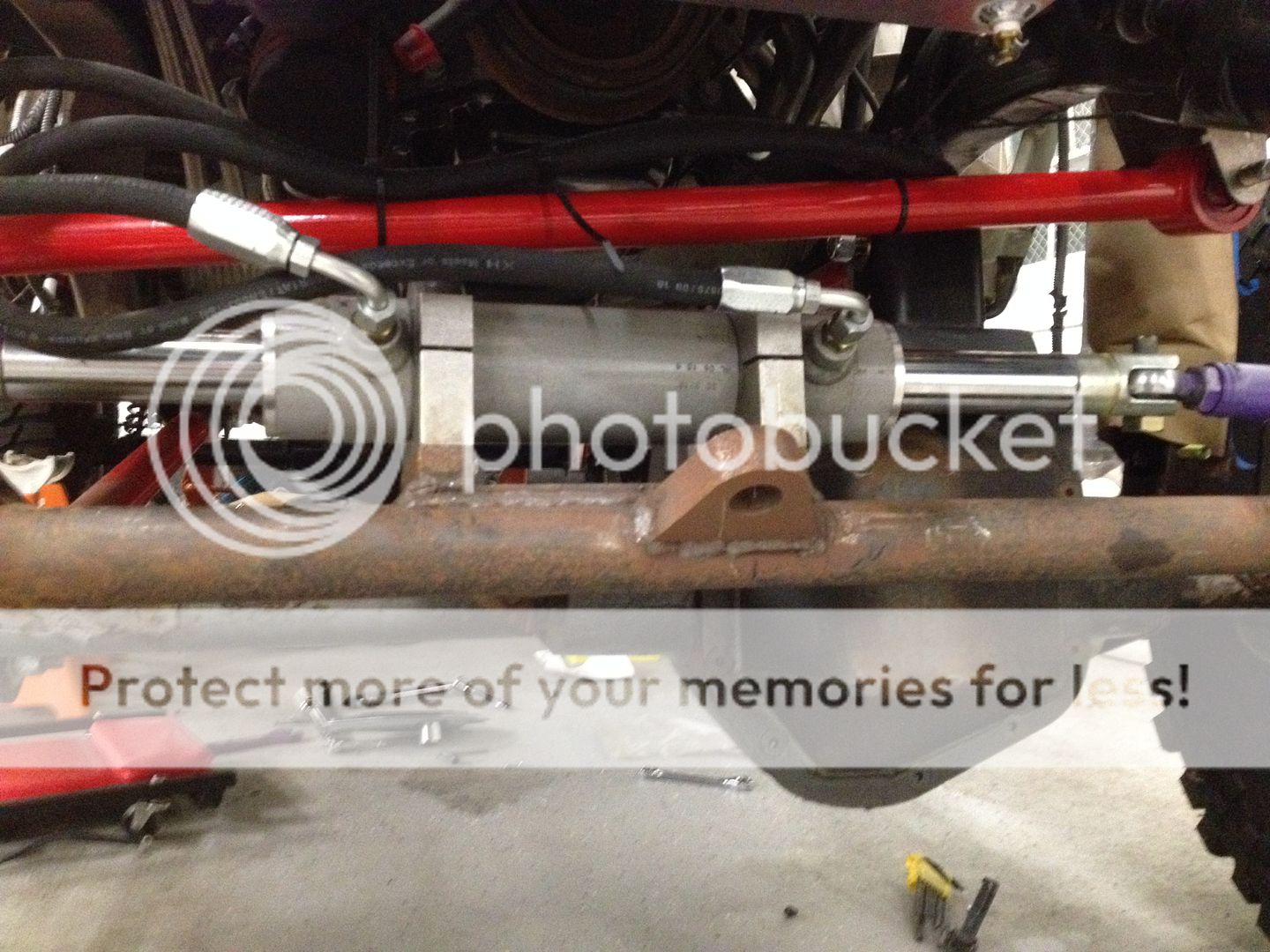

then... I got to messing with the hydro ram. I needed to rotate the ports to clear everything. fun part was looking for [2] specific fittings for the hydro ram.. that you have put your hands on in 2.5+ years.... thanks good I like to put everything in Rubbermaid totes!!!
made some hydro lines from the orbital to the ram... zip tied them up for now.

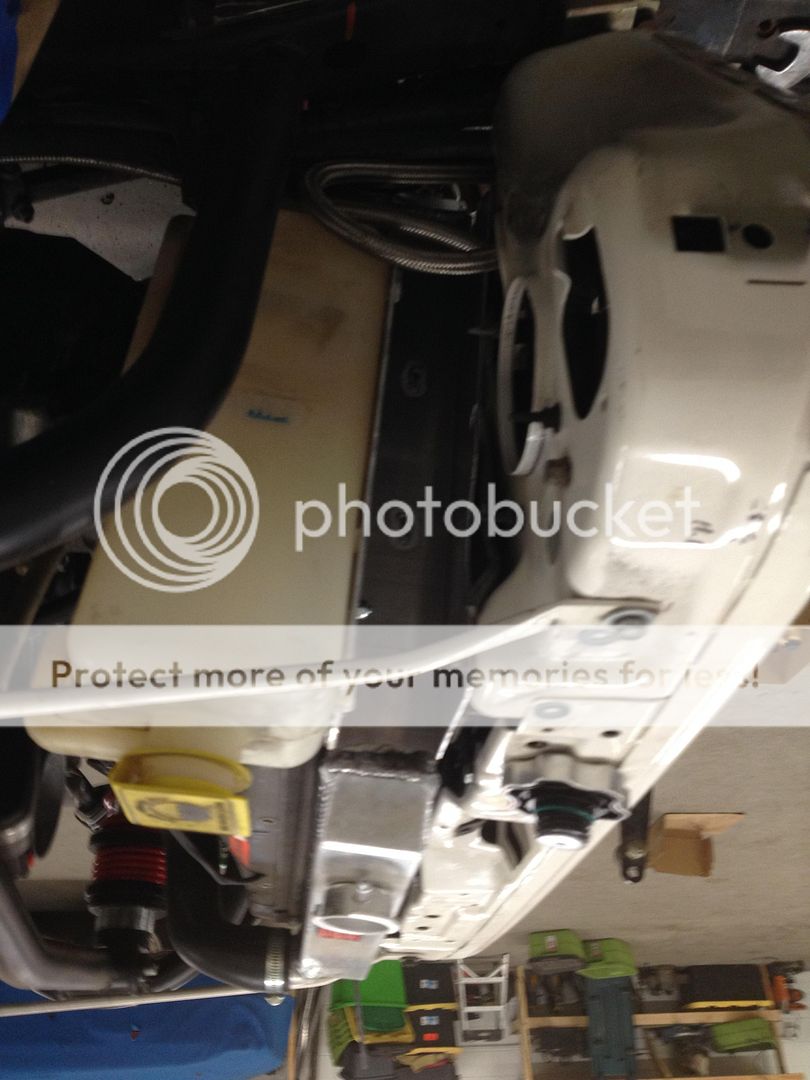

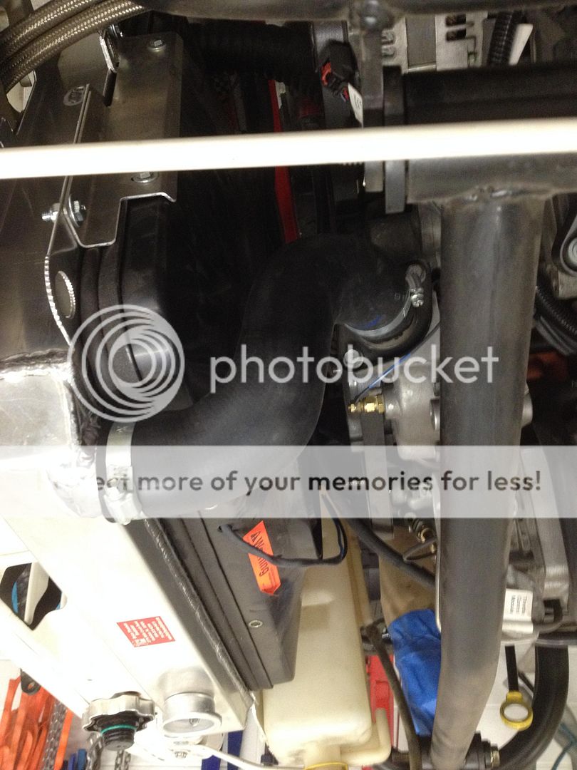

connected the lower radiator hose went I was at orileys buying $140 in new fluids for the beast.. I took a walk along the overbearing wall of radiator hoses in seach of one, perfect hose.. for the upper radiator. I sold the original BTR radiator I got for the swap as it had the upper on the drivers side. rad hose and intake fought for the same real estate. ordered a new BTR radiator with the upper on the pass side. so I needed a hose that went up at 45* then up 6" then 90* to connect to the rad... and be almost 2" in diameter... no problem... riiiiiiiiiiiiiiiiiiiiiiiiight!
halfway down the wall a twisted hose caught my eye. it looked twisted enough and of a large enough diam in the store that it may work. when doing the hoses on the hemi jeep, it took 5 trips to the parts store before finding ones that would work, so I was already prepped for the same cluster. how much is this hose... 27$ sweet! that's about 2.70 per inch. wow.
set the hose in 20 different orientations it seemed. marked it and contemplated the 'cut.' the kid that helps out up here was like 'are you going cut it there and see if its right'... I responded with it better be, its a $27 cut... all said and done... worked perfect!!!!

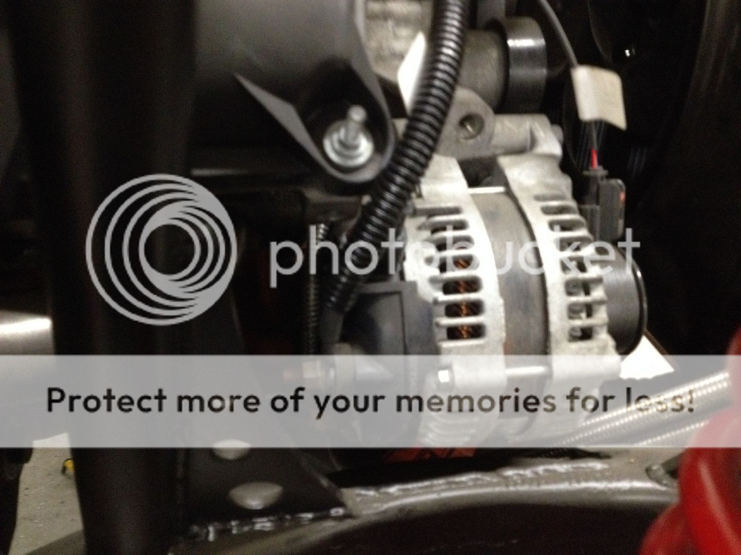

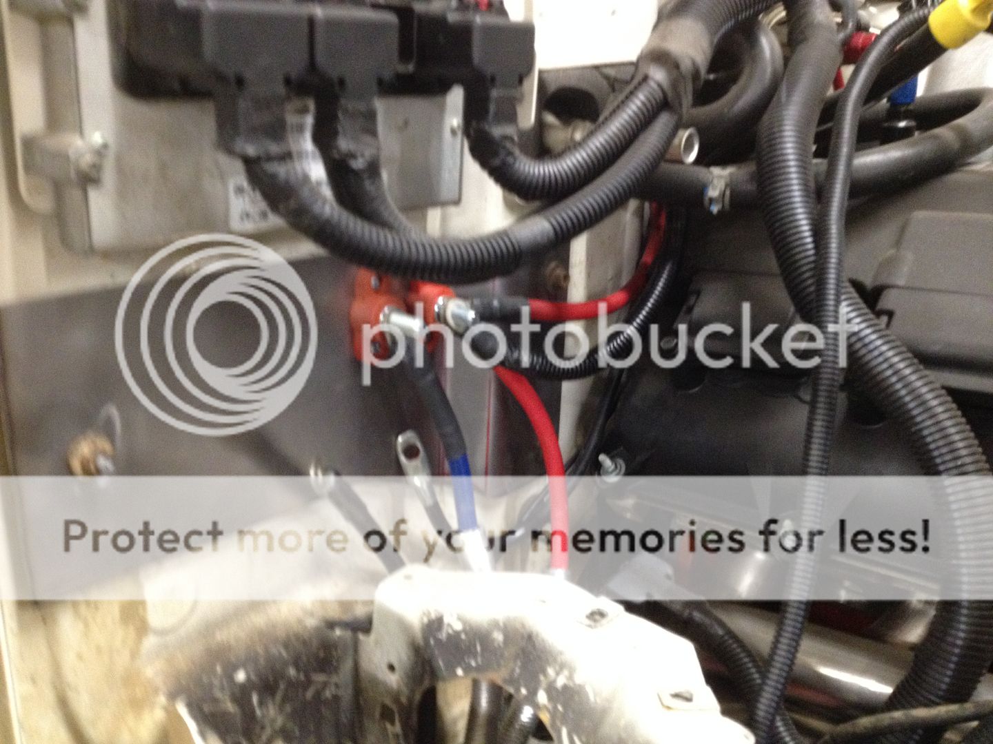

made a plate for the power posts and grounds on the firewall. think it will work fine. used the heater box mounting studs that were sticking out of the firewall
maybe ill be firing the 6.1 HEMI and the LS this weekend. that would be a good weekend

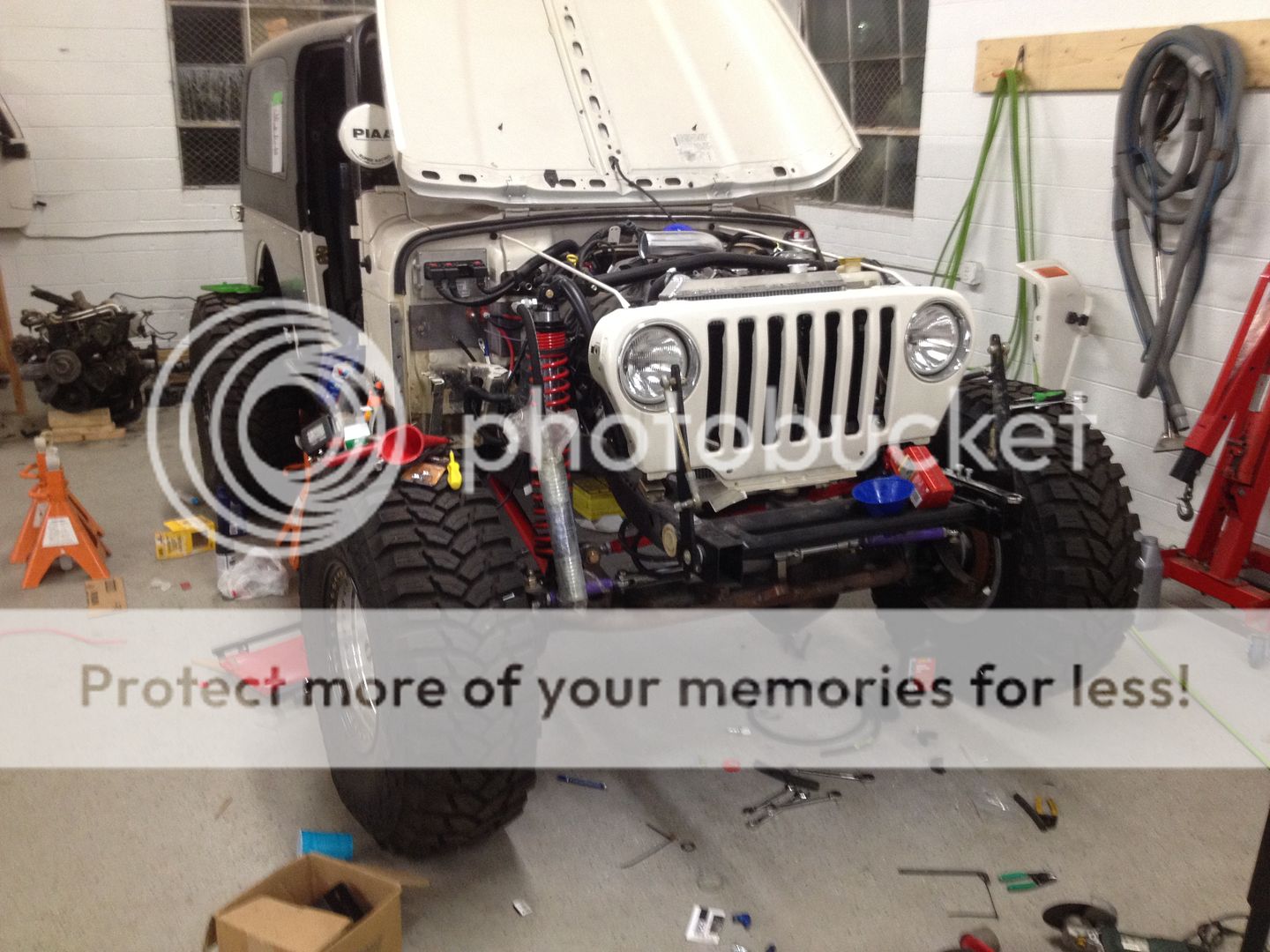

okay, so after a bath in amsoil filling the atlas last night...ehhhh! today I put the 3/8 plug in the radiator, hooked up the oil pressure gauge and threw it on the floor. I put 3 more quarts In the trans....pulled the fuel pump relay and turned her over a few times to prime the oil system and circulate fluid through the hydro system while swinging the tires side to side....
then... I put the relay back in... cycled the key a few times..and got this wicked #$@! please note the 8109 original miles and custom bullet hole in the windshield... then watch the jeep do the 6.1 hemi shake..
EDIT: CLICK ON THE PIC.... ITS A VIDEO OF THE HEMI FIRING UP!!!!!
