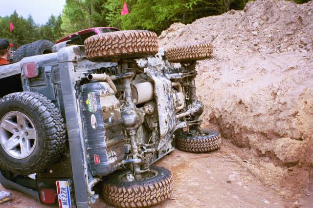

Originally Posted by theGiantPanda View Post
flopped on poser shot..... seriously.... sorry that wasnt kool...
you need to keep that a secret and come up with a kool story... like you were driving up a tree to stand on the front of your jeep to save a kitten for this hot chick and .....
i do have to ask.. were you in the jeep or standing behind the camera when the incident occured sir? do you have pics?
He's not the only one that's done something stupid like that
It had only 9k miles on it at the time...

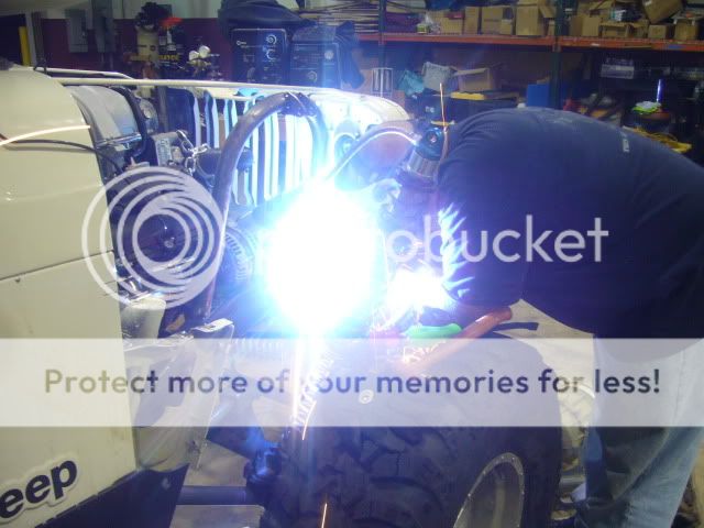

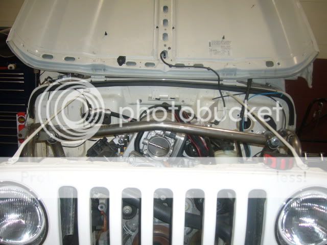

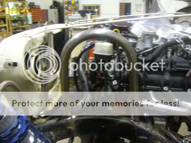

okay.... got some jeep time in today
and pics to prove it

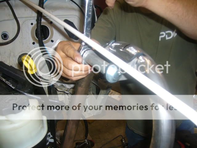

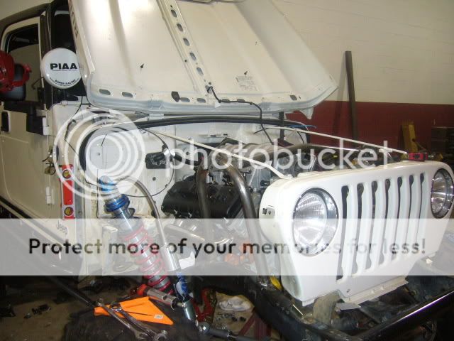

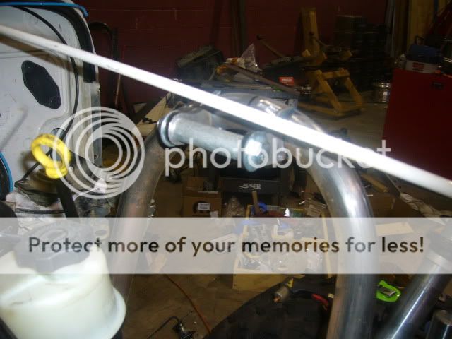

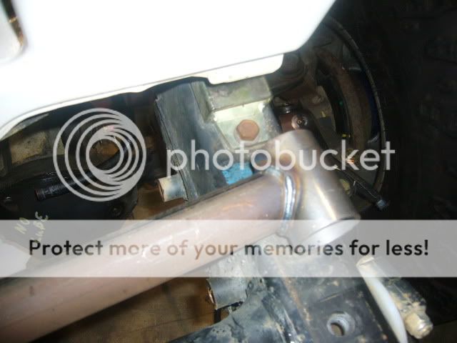

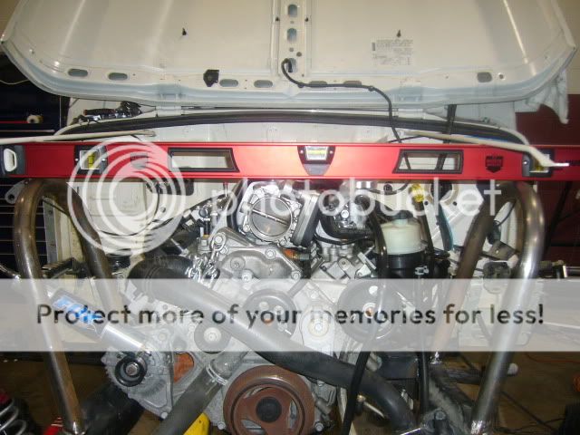

worked on welding in the new coilover hoops. i just had the pass side tacked in. so both sides are in and i got them pretty dam close. got the cross bar mounts in and crossbar made. pulled the stock steering box off. messed around with the coolers, mounted and remounted and didnt like anything i had going on. have to get on with summit and get a few different fittings to see what space i can gain.
ahh pics.....
started with the crossbar mounts. used a spacer to keep the correct distance between tabs while i welded them in
made the crossbar
set the cross bar back in while it was cooling.... looking good

the hoops and crossbar are .125 wall 1.5 od DOM and i used a set of poly bushings at each end of the crossbar to allow some flex. the spacers worked perfect and the assembly slides right in and tightens up nicely. i plan on using the hoops and cross bar as mounting points for 'things' as the engine compartment comes together.

What are you going to do for an air filter?
I usually see people putting a cone right off the throttle body, but I really don't like it uncovered, it's pretty easy for mud to splash there, not the lowest temperature area under the hood either.
Maybe some custom tubing near the headlight?
This didn't look to bad either.

emevol, can you send me the link to the pics of the orange jeep. looks like an ORU project?... im curious about the PS pump 'reservior' fitting. would be nice to re-use my factory pump and not spend $400 on a replacement one thats darn near identical if not infact the same.
as far as air intake plumbing is concerned.. i just ordered a $85 universal 3" turbo piping kit off ebay. i want to run my snorkel still and an air box. im moving the batteries inside and that opens up that whole fender pocket to run pipe and possibly the 'right sized' air box. i 'marked' a few different air boxes the other night after spending a little while scrolling thru misc ebay listings. definately want to run my snorkel, no question about it. it has saved me/us a time or 2 so far. plus havent seen a hemi jeep with anything like that. seems everybody just adds the cone filter like you said. ideally my goal is to be able to run the snorkel or straight off the air box; kinda like the Volant System i had worked.
started looking at the fuel lines... think ive got that licked... $50 in fittings from summit and i think im going to be good. just going to cut the stock stainless line, flare it and turn it into -6AN. got a fuel rail fitting and a couple of hose ends. will be able to keepit up on the firewall and awy from everything [steering/headers].
