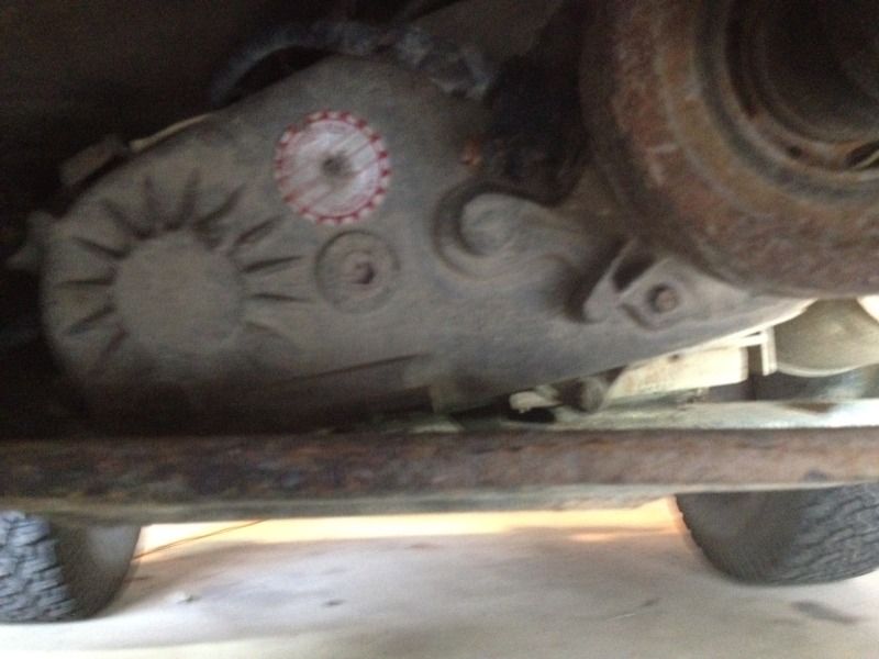

The 5 speed in my jeep 'moved' or 'leaned' towards the drivers side making it really hard to get it into first gear. Looking at the truck from the underside, the transfer case looks crooked. Meaning the drivers side of the t-case looks closer to the skid plate.

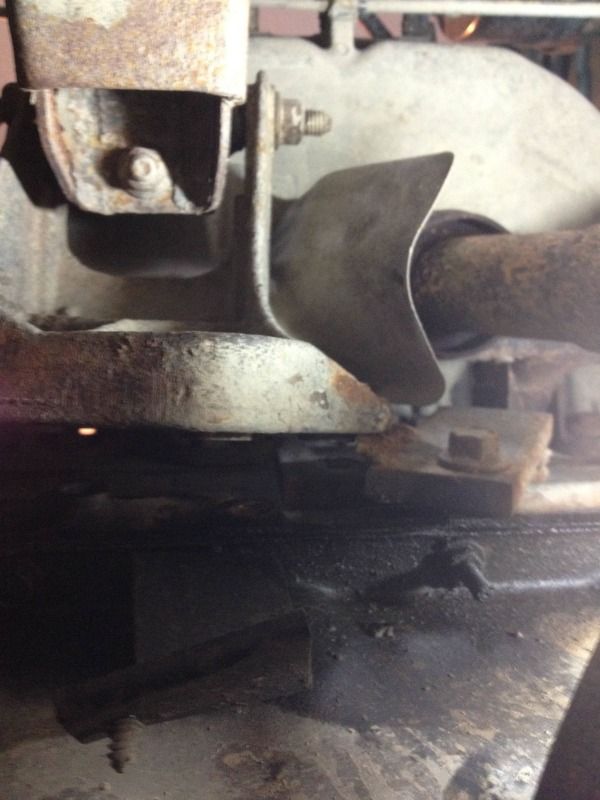

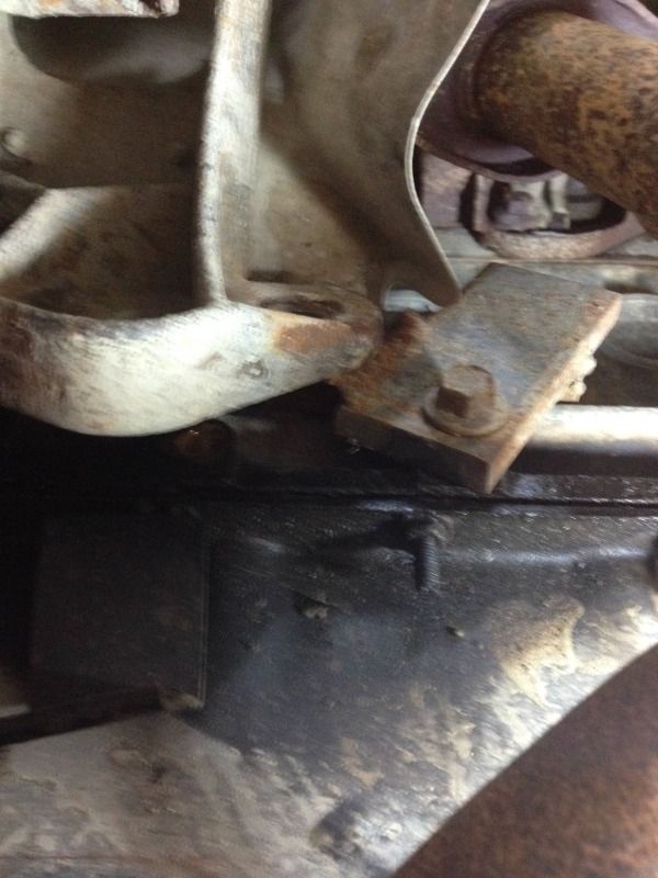

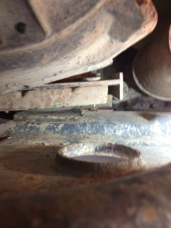

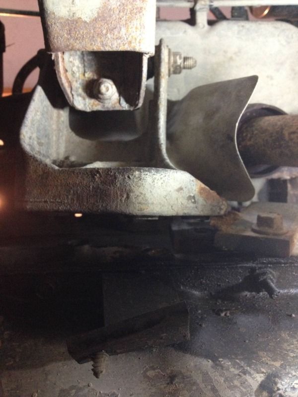

Here are some pictures

Looks like I found the culprit....Driver's side Motor mount is broken off. Lucky me! And even luckier, it looks like the previous owner welded something in here. What is this supposed to look like? And how do i get these broken bolts out of there?

After doing some research...looks like browndog custom motor mounts are the answer to this. Am I correct?

The OPs issue some or all the bolts on the block mount sheared off. Brown dog makes replacement ones that utilize the extra unused holes on the block. By the looks of the pictures the OPs rubber motor mounts are okay.

Yes, go with Brown Dog. You don't have to go with lifted mounts, which would likely necessitate the body lift. And their bracket replacement kits should be the ticket to get that mess straightened out.
I just installed Brown Dog mounts (1") in my Jeep two weeks ago and they're awesome, and the folks at Brown Dog were great to work with. I ended up spending extra on the rubber bushings to reduce tub vibration.
You'll be happy with your choice.
