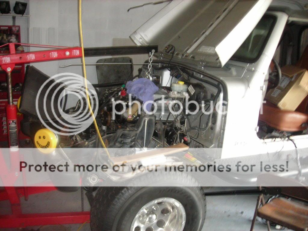

post #117 of 1200 Old 11-14-2008, 04:40 PM
sourskittle
Location: Lakeland, FL
Posts: 794
http://share.shutterfly.com/action/w...d=0OZtHDhsxY2w
Looks at pics 29-32.

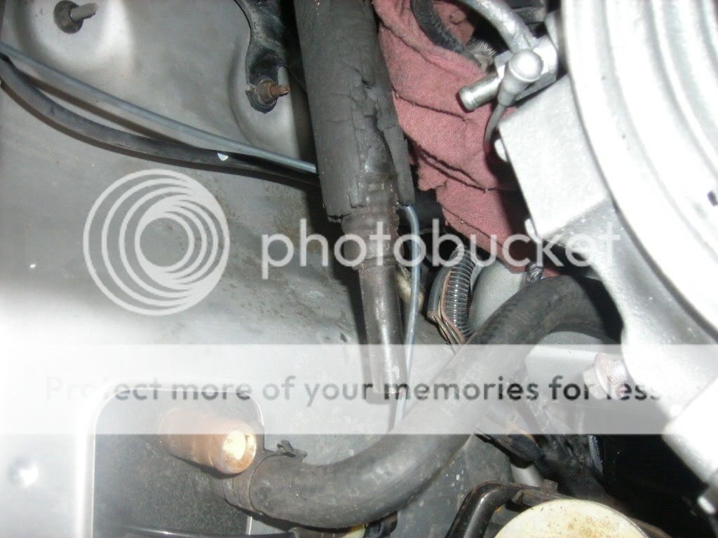

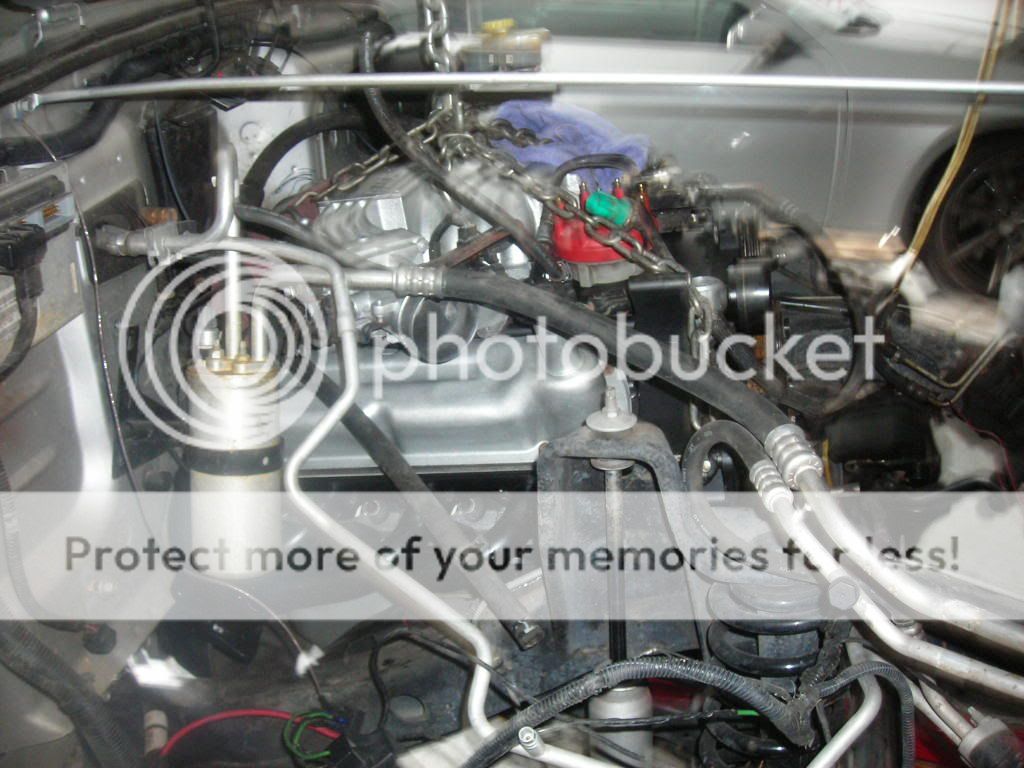

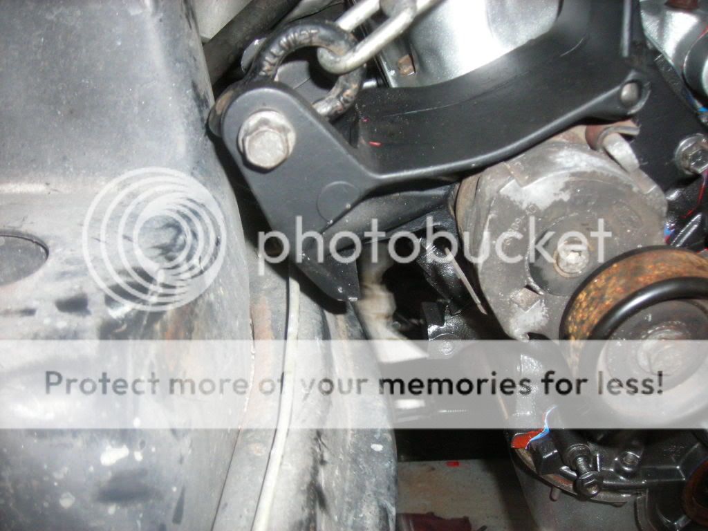

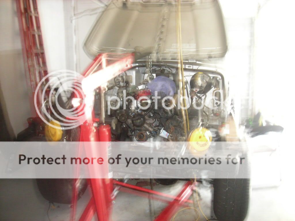

Got the motor in. Man, its REALLY tight. I think I'm going to build solid mounts. Amos, I can't see you haven't ran into problems with the A/C compressor hitting or the alternator bracket, or the headers, or the pass. valve cover...
Amos how long did it take you to do this swap ? I assembled the motor today, and dropped it in ( bolted to the bell ), but besides that, I'm wiped. And for the first time with any of my projects, someone actully came over and helpped !!!
I alread beat in the fire wall at the pinch welds like you said, I'm going to have to beat the fire wall in where the pass. valve cover sides too.
I would have taken more pics, but #1 I'm still using the same AA batteries that were dead a long time ago, I just hook the car charger up to them for a few seconds, hahaha. #2 These pics were actully taken in the 100% darkness. My Nikon camera hates my garage lighting, and I can't take pics without them looking all blurry, unless I kill all the lights, and put the camera in "night mode".
Amos, I wish you had a video or something, I wanna see that thing for every angle possible. If you had not already done this swap with a SN95, I'd say it basiclly doesn't fit. But I'm not giving up yet...

Thanks for the alternator info, that def sounds like the way to go. That looks like a tight fit in there, I was thinking it would be a little roomier, but I was thinking more in terms of length instead of width. If you were to fab your own motor mounts would it be possible to move the engine/transmission/transfer case forward? I know it would be a lot more work, but the 5.0L would be over the front axle more like the 4.0L, providing more traction. Or am I thinking of this wrong because of weight and balance/center of gravity. Sorry, I over think things sometimes. Either way I am beginning to realize I should have another vehicle to drive because there are a lot of little things you have to do for this swap and Murphy's law always rules.
