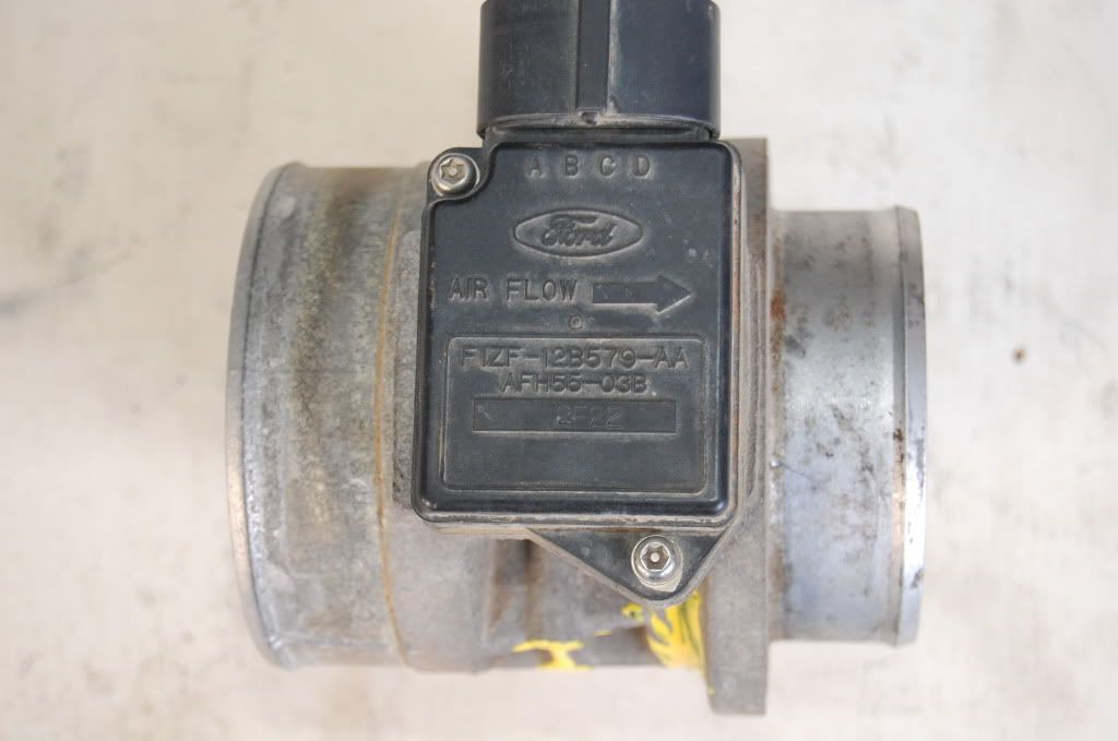

Found this at the junkyard today!
I didn't find a single 4x4 truck with the frame mounts I need. Every truck I found had the saddle type mounts. I know I need to find late 70's ford p/u 4x4 engine mounts or bronco but does anyone know the exact year or motor sizes in the p/u's that work. My buddy Jeff is going to do some searching monday and I wanted to give him as much info as I could

Looks like a winner!
As long as it is 4x4 and 77-79 i know it will work fine
