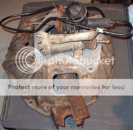

This is the bellhousing you will want. When you get it try to get the slave cylinder two with a chunk of the line still attached. When you get it home cut the line off but leave the fitting. cut the line off you jeep slave and once it is all mounted you will be able to figure out where to cut the jeep hose then use a small lighter heat the hose up and slide over the ford ftting leave it extra long so you can practice a few times
