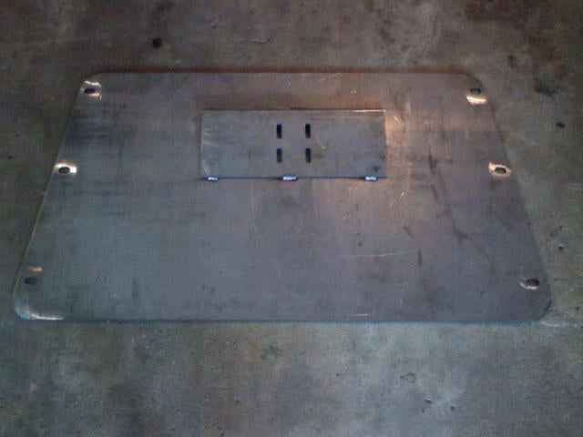

paydirtdave, the stock slip yoke rear output is crap. Put a SYE and associated needed parts high up on your list and you'll be able to run much steeper angles than a few inches of lift. Transfer case drops are just bandaids so there is no point in doing one with a fixed rear output and double cardan drive shaft. My driveline is seeing ~5" of lift with ~2.5" of suspension lift and a Rokmen skid plate, which lifts the t-case ~2.5". It will be going up another 2" soon with a flat skid. There will be no problems.

Mine. 1/4" plate. ~3/16 channel for the transmission mount. Simple as that.
That will tuck things up HIGH, possibly a little too high for my likings. It will raise the t-case ~4.5" over stock.

Mine.
Nice.
It never occurred to me to just make my own, and I've got a piece or two of AR500 plate laying around that might work. I'm keeping my stock springs and only putting in a spacer where needed to level out the suspension, so I should have plenty of room. Will a 1" body lift will be enough to allow something like that?
I've got a 1.25" body lift so a 1" should be just fine. It's a TIGHT fit, though....and that's with a low profile transmission mount. You'll also need to lower the fan shroud a bit, cut down the exhaust mount to lower the cat (and muffler if you still have one) and will need to ditch the factory t-case linkage. I will probably space it down 1" but we'll see. 20" @ the belly on 2.5" of lift and 35's is sweet.
