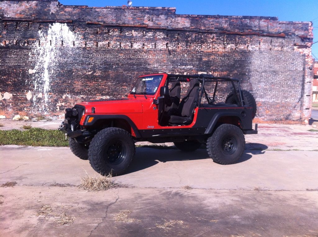

This is my old setup that fits your question on lift exactly. Just the tiny-est bit of trimming just behind the rear wheels.
How big were your bump-stop extensions at the time?
They were set to the travel of the jeep. I didnt take measurements.
