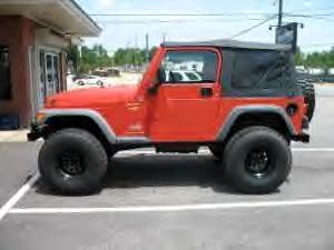

Originally Posted by XtremeJeep View Post
Just add the 1" body lift to that kit and 35's will fit perfectly.
Thats what Im running. Look at the pic in my sig.
