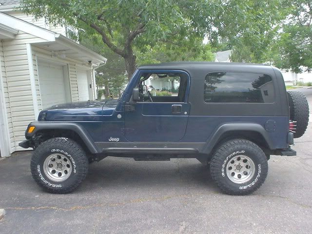

You like to give your opinion on big tires and gears when you've never seen anything above a 31.
and your Jeep has never seen anything but a paved road or driveway, yet you give your opinion on bumpstop length and whether a lift will fit certain tires, without ever checking clearances properly.
btw, these aren't 31s.
but I couldn't stand using 2nd and 3rd gear and 4000rpms trying to maintain speed above 45mph on country roads and Denver highways, not even venturing into the mountains - Story.
