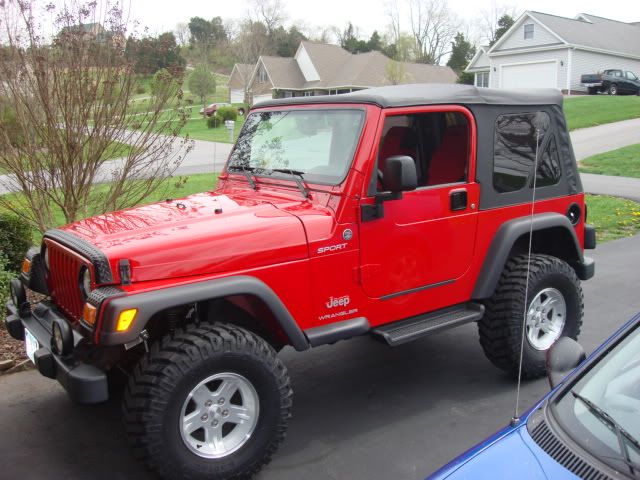

I recently installed the Zone 3" lift with Nitros and 3/4" front coil spacers. The ride is stiffer than I expected, but not too bad. I needed the TC drop because my front drive shaft kept bouncing around. I think the extra 3/4" made it too short. The kit comes with a subtle 3/4" TC drop which is hardly noticeable.
minderbinder3 is offline
