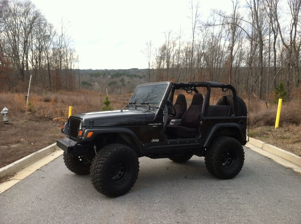

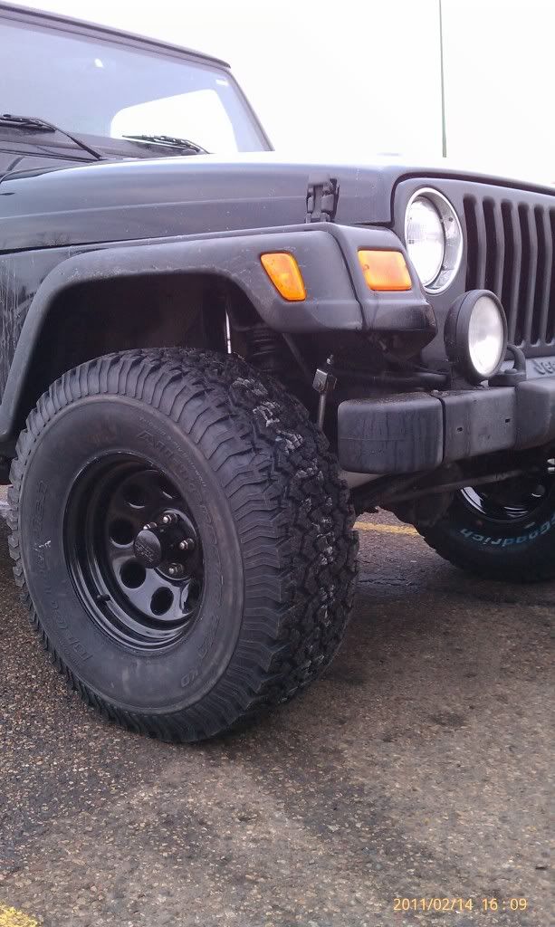

Originally Posted by Zone_Offroad View Post
You can run up to 4" BS wheels and still clear. We've done many with the black US wheels that come in a 15x8 4"BS with 33x12.50's.
3" lift, 4" backspacing on 33x12.5's -

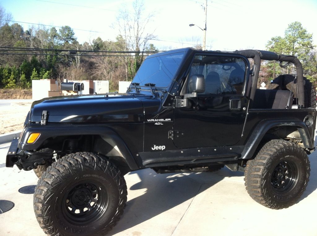

Posts: 3,664
3 inch zone lift, 1.75 coil spacers up front
