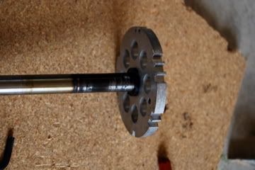

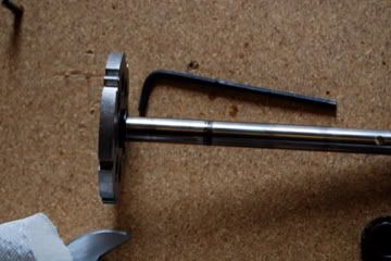

I fill the reservoir prior to installation. I coat the shaft prior to installation too so there is something on the entire shaft (I have a groove cut for my lower bushing that collects some grease otherwise the upper seal will wipe the lower portion of the shaft clean).
When I did the FogMOD the first time after it was back together I added grease until there was loading pressure on the shaft and it was tough to spin. That was too much. I relieved the pressure so the shaft would spin okay.
After the OPDA was installed and ran for a couple thousand miles I pumped 2-3 shots of grease using the needle adapter until it was tough to pump the grease. When I removed the OPDA for inspection the shaft was coated nicely however there was a dark patch that I was disappointed with.
Here is a shot of the shaft. Notice the darker area on the bottom portion of the shaft.
My guess is too much pressure/too much grease. Tkki had no discoloration on his upper shaft. Below is Tkki's results (all photos are on the first page along with other result photos).
I reinstalled the OPDA after cleaning the shaft and didn't add any additional grease other than the coated shaft. When installing the shaft the grease will collect along the seal and leave the upper bushing well coated.
I haven't checked it yet, but I think in this case less is more. I wouldn't add more than one pump once or twice a year. Maybe tkki can chime in with specifics on his approach.

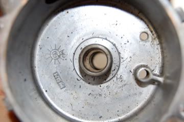

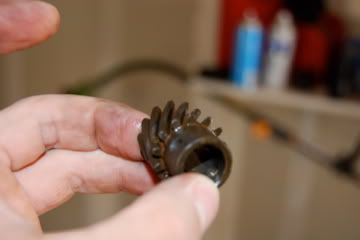

Well, I got a new ODPA, did the FogMod and here is my report.
*The new shaft is different from the old, meaning the hole in the shaft for the pin is tapered, whereas the old is not.
*When spinning the new one before/after the FogMod, my old one spins night and day better. To the point one good twist equals about 2-3 full turns. The new one only does a 1/2 to 3/4 turn. Any ideas as to why?
*The old still had some form of grease in it; however, it looked like most everyone else except my gear seems to be as it should.
