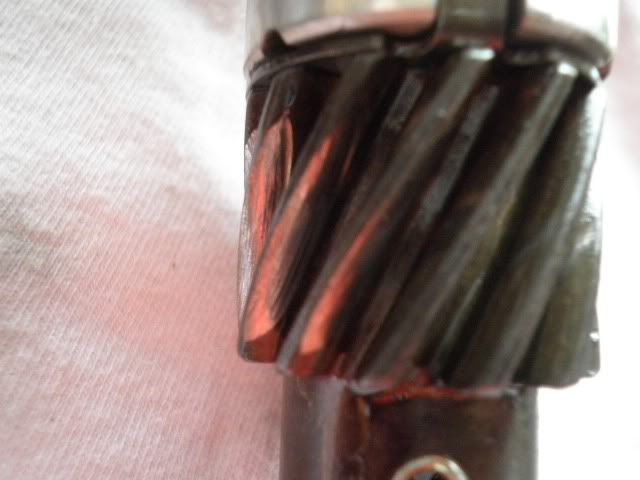

I used Mobil 1 High Mileage (the previous high zddp stuff) for nearly all of my Heeps 65k miles with no symptoms either. Pulled mine after seeing these threads a couple months back and my OPDA drive gear was worn to the point you could shave your beard with the razor sharp teeth.
You have nothing to lose by checking it out, but catching a possible failure to gain.

I wouldn't call that bad wear. I've seen worse in pics.
