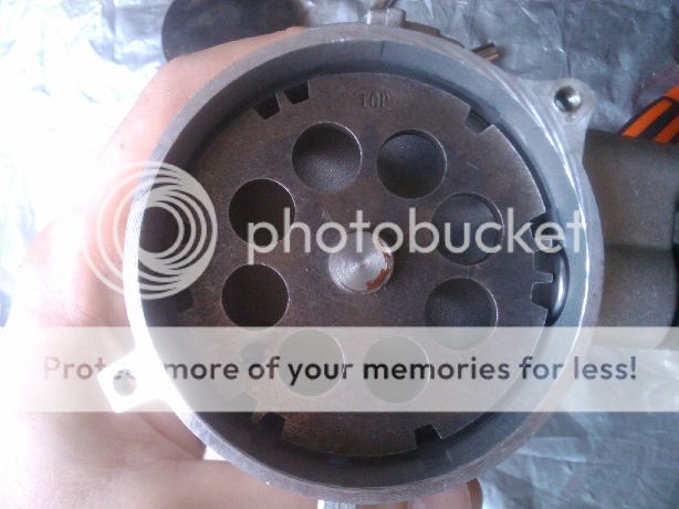

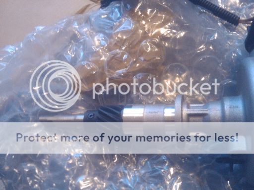

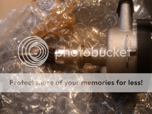

I just installed the Crown unit today, replacing the Dorman unit I put in my TJ 4,000 miles ago (61k currently). The Dorman unit is probably fine but after about 1,000 miles, I noticed it never ran as smooth as it did with the OEM OPDA plus was a bit harder to start sometimes. I did not swap out the CPS sensor with the OEM/Mopar one like I did with the Dorman so hopefully Crown did a good job on that as well.
So far I noticed it seems to run much quieter/smoother and starts up easily but only time will tell since I put less than 5 miles on it today. From what I can tell, you can't go wrong with either the Dorman or the Crown so far but the Crown does seem to be a bit better build quality visually. I also checked my cam gear, it looks like new which is a good sign and *maybe* using VR1 10w30 oil has helped.
Here are some pics below of the crown unit, cheap cell phone quality though:
Don't understand the "red" mark on the top, must have been from machining the target wheel:
Build Quality on the Crown OPDA gear looks excellent:
Dorman with 4k on it at the top, new Crown Unit at the bottom (the gasket is on the crown):
Dorman up close, I noticed "shiny spots" on the gear with only 4k on it:
