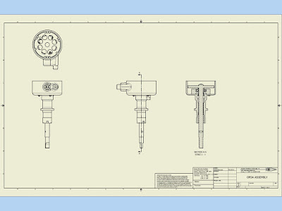

Ok gentlemen,
Here are the finished detailed drawings...
All that's left is to mfg the few components and buy some raw stock and a handfull of bearings... I'm away on business for the next few days, so nothing more until 5-9-12 or so...still waiting for a few quotes as well.

Thanks for your hard and dedicated work!
Any way to get larger pictures posted somewhere?

Wow, if this does not require lathing of the top bushing area on the housing it is very similar to what I originally planned. My design used bronze bushing material with a seal. I even contacted a bushing builder to see if it was feasible and a estimated cost. I think if enough oil gets up there this will work great. I also think this is a great mod to do my flow though design with as the seal will be centered perfectly and more oil will reach the bottom bushing and gear. Put me first on the list to order.
