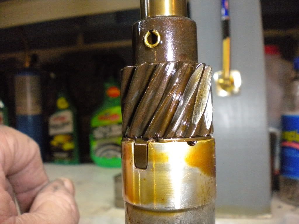

Originally Posted by willydigger View Post
Here are some update shots. I pulled the OPDA during an oil change before winter. These results are with 78598 miles. This is nearly 10K more miles than back in March 2011.
[Upper shaft wiped with rag. I'm still not impressed with the discoloration.
mine had similar discoloration after about 10K. I think you'll find it's staining caused by the 5% Molybdenum Disulphide thats in the AeroShell 33MS grease and is not caused by friction, heat or wear and therefore is of no concern.

jutgin
Location: chattanooga
Posts: 560
How do you think mine looks?
That looks pretty bad. Did you get a look at the gear on the cam while you had it out?
Yes, couldnt get it to come out clear in a picture. Although it looked great compared to this.
So what causes this abnormal wear? I was thinking this was all about the top bushing not being lubed, how does this gear wear abnormal?
Two separate issues. The FogMod is the easy fix. Finding the culprit for the wear issue is the mystery.
