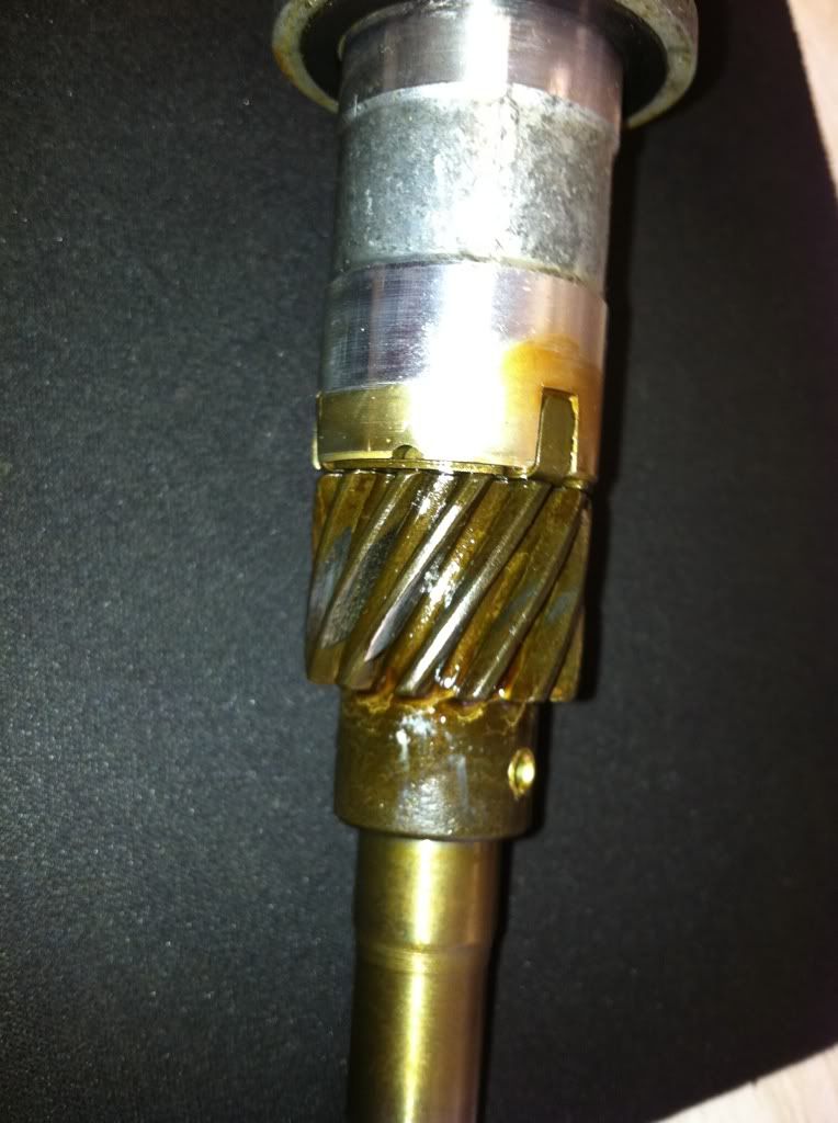

Pulled and checked mine the other day. Spinning the shaft felt smooth but a little tight like a seal rubbing, so I guess its ok for now. My plan is get a new one and Fogmod it and swap it in.
Opinions on the gear wear please?

That wear doesn't look bad at all.

The wear pattern is wider than ideal but not terrible. I would suggest that you pull the shaft out & give it & the top bushing a little shot of oil. Remember that the gear only goes back on one way. Mark it before removing.
