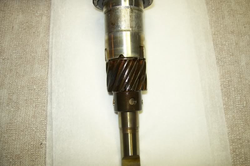

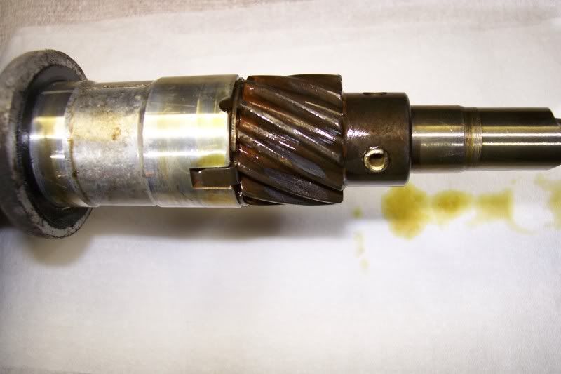

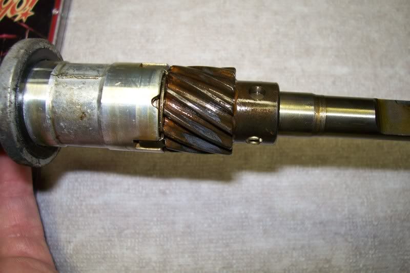

UPDATE:
Okay guys, for those of you who don't know I had my OPDA diagnosed at the dealer as instructed by Chrysler. Of course the dealer said there wasn't anything wrong with my OPDA. Thanks to willydigger's excellent video I was able to pully my OPDA today and take some photos. I also changed my oil to Mobil1 5w-40 Turbo Diesel Truck today as well.
These pics are at 28,100 miles on a 2005 TJ X. The shaft spins amazingly smooth, and I feel the wear marks aren't extremely bad. Still at only 28,000 miles, I feel as though they are excessive. I will be installing a modded OPDA as soon as they are made available, but I feel confident with the new oil and as easily as the OPDA turns, that I will be fine until I can get the modded unit installed. Again thanks to all that have contributed to solving this problem especially willydigger and Fog.

That's 28K with at least one replacement gear (based on the additional roll pin holes. Do you know when the new gear was installed? It has a good amount of wear for two gears.
As long as it moves smooth you have some time. When it starts to bind is when the crap hits the fan. Hopefully you'll have the new one sooner than later.
Gear was replaced in December of 2005. So it's been quite some time. It's lasted this long. I'm crossing my fingers for February 14th. It really does turn smooth as silk though. Let's hope the Mobil1 oil will help it last a few more weeks!

Okay that makes more sense. The replacement gear is old. The oil should help with the gear wear. It won't do anything for the upper bushing seizing, but if it runs smooth I think you'll be okay for a few more weeks (hopefully weeks).
Are you planning to dissect the old unit? I'd like to get some pics of the old shaft upper bushing.
