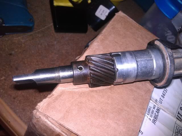

Well F me.. Looks like the new unit will be going in. Brute force doesn't work well for installing the roll pin for the gear.
I thought I read something about matching it up, and also a TDC method for istalling. I just looked, but seem to be having a hard time finding the info for installing a new unit.

The roll pin was kicking my ***, and I thought I'd pound harder. The gear collar broke. On to the new one. I just did the Fog mod and need to figure out the roll pin. When I start on one end the other end is off enough that the pin doesn't want to go through. I'm sure it's part of how it holds the gear on, but I'm gun shy now.
I used the sharpie method. I thought I read you can just make the new one match and install, but I couldn't find that info with a quick search. I'm hoping to not do the TDC method cause it sounds like a pain.
Edit: Sometimes I wonder with all have done and the places I have been how I have survived. If the roll pin doesn't want to line up spin the gear around.

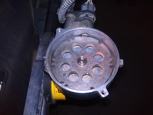

I hope you took pics of the wheel position before you pulled it out. I line up the word "TOP" with the CPS sensor in the unit and mark the back edge with the block and take a picture. Its all good reference so you don't screw it back up getting in. First time my sharpie marks came off - lesson learned.
Picture of my original unit removed at 78k, now fogmodded. I installed the new one and have 4k miles on it now. Can't wait to see what that gear looks like on the new one. I was very happy with gear wear on the original. It might be going back in soon.

I use the TDC method, it's not hard. If you got the holes lined up and pinned between the housings and the tone wheels first, then transferred the marks you should be good to go.
