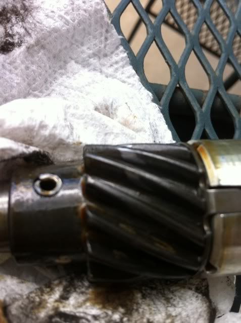

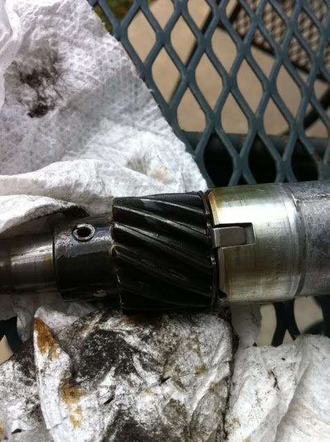

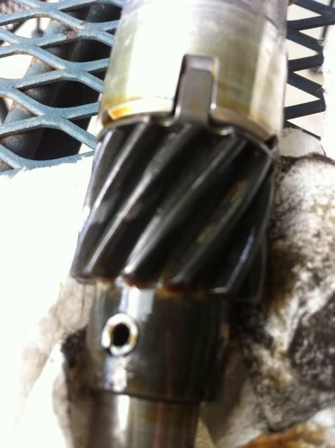

UPDATE:
Changed my oil today after 5,000 miles with a modded OPDA that I got from Willydigger. I was running the Mobil 1 TDT oil and today I switched to the Valvoline VR1 10w-30. Pulled the OPDA to inspect wear and was happy with the result. The gear was slightly used when I got it from Willydigger and it looked the same way the day I dropped it in. It's only been 5,000 miles so this may not be a good indication of whether or not it will abnormally wear. I do plan on pulling it every oil change to inspect. I will also note that I was in a hurry and didn't have the OPDA lined up correctly when I reinstalled it (I think the target wheel was off half a turn). The Jeep wouldn't even start with it this way. So I reinstalled it and took my time to make sure it was lined up correctly. No problems, no CEL. Here are a few pics.
Sorry about the blur (iPhone)

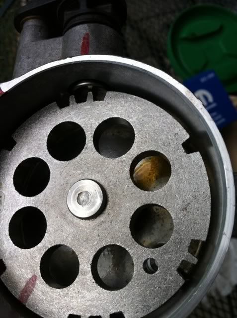

The housing did have some oil in it when I pulled it, can be seen here

Originally Posted by ChaseB View Post
UPDATE:
That's odd. That indicates a seal failure. That might not be a bad thing, but keep an eye on it. That would mean there is enough oil and pressure to fill the bottom bushing containment and squeeze through the seal, and finally past the grease layer. Since it's not shooting out everywhere, any lubrication is good lubrication.
I would be thinking that is not oil,but grease that has broken down with heat and lost some of its viscosity or " thickness ". If oil has gotten past the seal it will wash the grease off. Anyways, congrats on the lack of wear shown.
I kinda agree. I canít imagine that much (if any) oil getting past the seal AND the grease packed around the bushing. What grease are you using? From the last photo I see that it ran down to the low side of the housing (when in the engine) but in that photo it appears that it stayed there now rather than running to what is the low side in the photo. Makes me think it is grease that flows when hot then solidifies as it cools. Is it thin like oil or thicker, more like grease?
Some greases have a large change in viscosity with relatively small temp changes.
That gear wear pattern looks great.

I agree with gear wear being a normal event. What we are seeing is premature and due to oil and eventually upper bushing.
I question the oil recommendations on your list only because of the dates. The post linked to the corvette forum was from 2007 and we know the oil additives have changed over the years. I would recommend contacting the oil manufacturer with oils you are curious about and as a last resort send it out for an oil analysis.
I think the Mobil 1 TDT and VR1 are suitable from what I've read here and based on the manufacturer replies to our concerns. I remember a discussion years ago about Rotella T and the shrinking ZDDP levels.
FOG mentioned this a long time ago regarding acceptable gear wear. You should have a small patch in the middle of the gear. Anything more than that is a sign that oil or bushing design is faulty.
With regards to ticking the difference in oil weight could play a roll. While a 5w40 and 10w30 are close there is a difference that you may notice. Assuming Chase switched to the 10w30 from M1TDT. Also with changing oils the filter may be leaking past the check.
