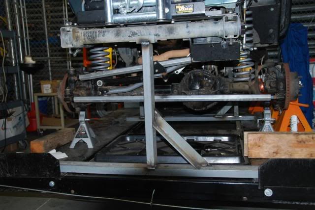

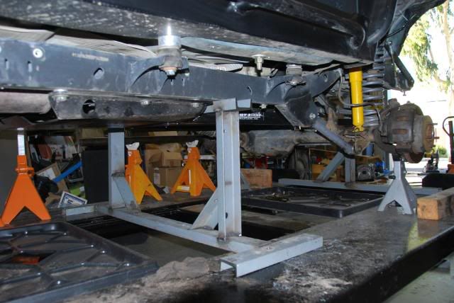

The last couple of days I've been busy building frame supports so I can leave the Heep on the rack. Since my lift is a drive on it really is not made to take entire axle assembly out. I built a center and front support. I found the heavy steel in the back of one of our trucks that was going to the scrap yard.
Today I got the front axle assembly out and placed the 609 in to see what I'm working with.
I have a lot of cutting and grinding to do. Then I can starting mocking up the front 3 link.

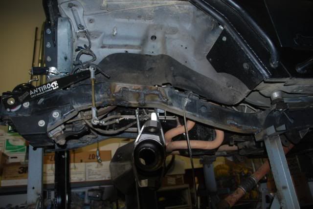

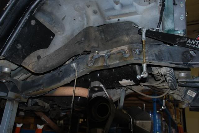

Yesterday I plasma cut the old brackets from the frame. Went pretty good and only the track bar bracket took a while.

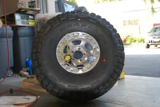

I grinded the remains of the old brackets. I HATE grinding!
I also got some new to me 17" Champion Beadlock and Goodyear 40" MTRs. I mounted one to see how f'ing big these things are.

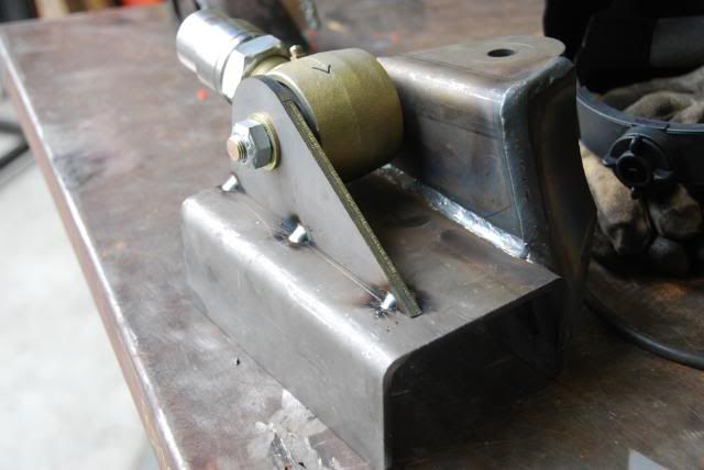

Started building the brackets up for the front 3 link. Robert at Genright is a Gem! He is so helpful! Genright kits kick butt! The brackets come with all of the nice braces and gussets to really make a strong system.
This is the driver front bracket that will have the upper and lower control arms. The passenger side will only have the lower so I don't have to worry about the exhaust up front. When I get to the back that's a different story.

post #115 of 694 Old 08-28-2008, 09:59 PM Thread Starter
Savvy
Vendor
Savvy's Avatar

Good work with the whole project. Do the genrite frame brackets not come fully welded?
1999 Jeep TJ on 1 tons (OLDER)
2003 Jeep Rubicon (OLD)
2008 Jeep Unlimited X (NEW)
tweba99 is offline
post #120 of 694 Old 08-29-2008, 07:30 AM Thread Starter
Savvy
Vendor
Savvy's Avatar
2014 JK Wrangler
Location: Tustin, CA - Orange County
Posts: 7,087
The brackets come fuly welded. You only have to decide which side you want the upper one. Then weld up that tab. The holes are predrilled in both.
