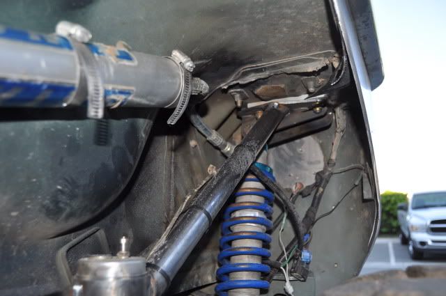

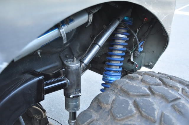

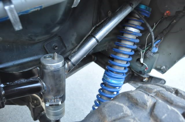

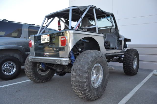

Final picture post for Unrolled as the new owner is picking it up at KOH.
Dallas did an interesting stretch. In the process of moving the axle back 4" he raised the rear bumper up and triangulated the back half to included the stock mount, air bump cans, tub support, C-pillar cage tie in and bumper mounts.
Dallas did an interesting stretch. In the process of moving the axle back 4" he raised the rear bumper up and triangulated the back half to included the stock mount, air bump cans, tub support and bumper mounts.
There appears to be paint worn away on the coilovers... Are the coils rubbing on something? Other than that, it looks fantastic.

The coils were rubbing with the old outboarding kit. Now the coilovers are farther in so they should not rub.
