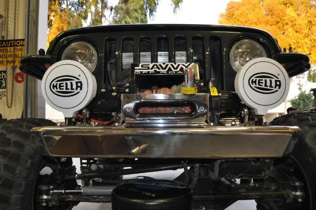

The latest bling! Polished aluminum and stainless recovery points. I do this to show alternatives!

God Gerald, Blaine must hate you for that. I can see you blinding people on the roads with that. That is sharp though. Is nice, but not very practical.

I know! Though it is not everyday you see that much bling out in the desert!

Psst, the winchline goes through the fairlead, Gerald

How do you think I get the bumper so shinny! I use the rope thingy as a buffing pad!

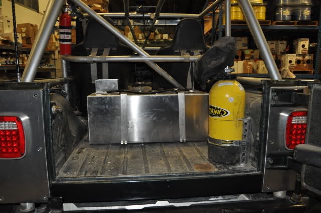

The Jeep lost 33 lbs today as I removed the extended gas tank and skid and put a fuel cell in the bed. The emission control system has already been relocated so the hoses were already consolidated to a single hose to attach to the new fuel cell. The electrical connection just needed to be rerouted and same with the fuel line. The stainless steel braided line use an AN-6 compression fitting on the fuel pump output so all I had to due is reattach the reroute fuel line and I was good to go!
I had been having trouble with the Jeep stating after it sat for a while. I put a new fuel pump in and now it dosen't have that problem any longer.

I don't believe we've seen those tapered taillights before... I guess you've got to keep some of the cool stuff to yourself

Polish that fuel cell too?..Your out of your mind...
And neZZr, actually those lights have been out for a while now
