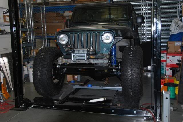

Finally got some time to start working on the front axle today.
I got the shock hoops and coil overs mocked up.
Full stuff

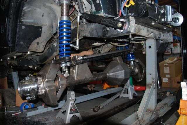

Finally got back to the Jeep and i'm almost done with the front. I just need to add weld some steering arms for the tie rod and place the limit straps. For now it is on 40's so I can flip it around and strat on the back. I'm hoping it will not take as long.
Top cross brace mocked up
Drag link and track bar are parallel but the track bar need 1.5" to be perfect. I expect a little bump steer.
It is a little low right now as I have not adjusted the coilover yet. It will probably go up 2-3". I'd like to keep it here but then I'd only have 3-4" of up travel.

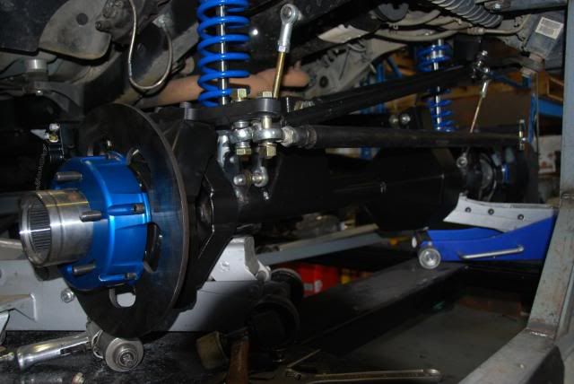

Spidertrax hats and rotors with Wilwood calipers make up teh front brakes

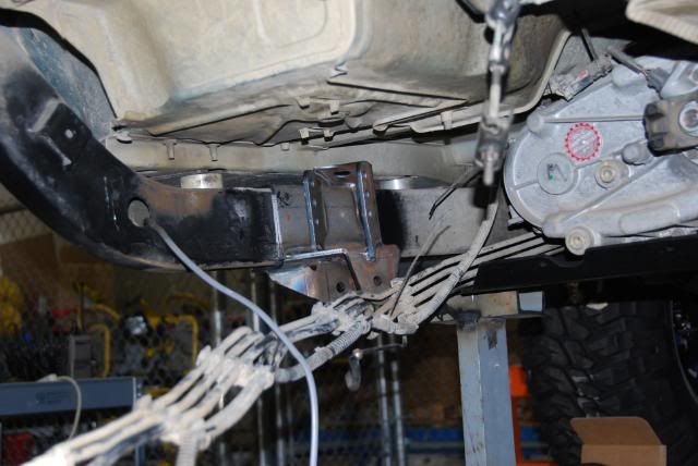

Yesterday, I fianlly started on the rear and got a little done. By far my least favorite thing to do is cut out the old brackets and grind everything clean. The plasma torch makes it a lot easier.
Old SA & spring perches are now gone
Four link brackets will sit here
Now I just have to wait for the Currie Iron Jock Axle. I hope to pick it up next week so I can get the Jeep back on it wheels. There is still a bunch of work.

Whatcha gonna do with all them fuel, emission, and brake lines?
I am Savvy

I'll probably do what you showed me and route them up and to the outside of the bracket. I was also thinking I could mount the emission stuff underneath just to the right of the bracket.
