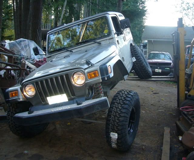

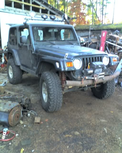

why do ya want 5"'s of lift just for 35's?
I also would say go for a tummy tucker (which in it's self will nearly give ya the clearance of a 3.5"), cv shaft, oil pan skid and a dependable winch with the 31's or 32's with some 2" spacers/another inch on bumpstop only in the front to level the rake.
the huge lift will only make it look cool, it won't be so cool to drive everyday....
here's a 04 I just got done with... it has 37's under a 3.5" RE lift and DIY highline fenders.
and 34's on a 2.5" rancho with a DIY highline. it'll have 37's on it soon with no additional lift.
lifting er to the moon isn't the answer, simple mods will make ya a whole lot happier especially if it's not a regular hard hitting weekend warrior.
