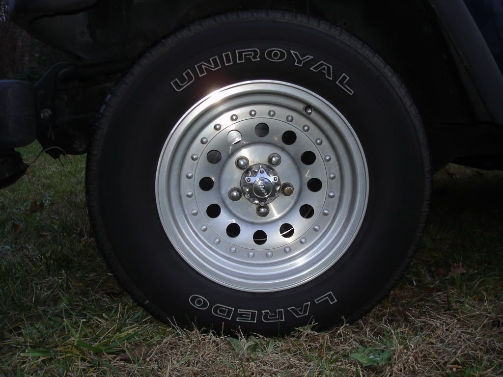

i was looking through the documentation on things my dad has done for the jeep and the wheels are 15x7 pacer wheels, i dont know the exact model because the website didnt say it had a model name. but how do i know if the tires fit the rims,
Would it look bad if i powder coated the rims? and how much does that cost, ive gotten a wide range of cost

Like Jeepin said, a 10.5" wide tire with fit your 7" rim nicely. And as for powder coating it would probably be cheaper to just buy new wheels because I've seen people with car wheels get quoted no less than $75 a piece. (but I don't know for sure, so check)
For example: these are $65 each and will prevent any rubbing and allow you to go with bigger tires in the future. http://www.quadratec.com/products/92601_4XX_B_PG.htm
I'd just spray yours myself. I've just seen people sand them up and use playing cards or index cards to wedge between the tire and the wheel to mask it off. Usually turns out pretty good. Powder coating would require you having to remove the old tire(since they bake it at 400*-500*), get it coated, then take it to a shop to get new ones put on. Could get pricey. Check it out.
