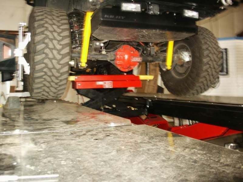

this is the reason for a relocation bracket even with an adjustable track bar.... Yes.. it's a JKS. also notice how much further the left tire is off the rack, the other is touching the rack... and no, it's not from the lifting point.
BTW, the shocks are n67L and are no where near fully extended, they are hanging from the bound up track bar. a relocation bracket eliminates the bind.
there is also only 2.5" of uptravel due to the "L" shocks on the 2.5" lift and shock mount extensions.. which stinks to high heaven for ride quality.

Mine has a very slight bend, but barely noticable - maybe 1/16", not even the thickness of the material. Nowhere near as bad as that. I've got the standard length shocks. Why not weld a 1/8" plate over the top, and use a grinder to notch out a small C? I had considered that, and still may, but the deformation is barely noticable - and I could have possibly did that during install.
That still does nothing to correct the geometry. Ideally, the track bar would be parallel to the axle so you either raise the axle end or lower the frame end. The steeper the angle of the bar the greater the lateral movement of the axle when cycling the suspension.
I don't think you've hung the axle enough to harm it, I know if you jack up the rear by the frame/bumper, the left side will not hang as far as the right and will bind on the top of the bracket. I have cut em off and rewelded the top, without a relocation bracket and brace, they still twist and break right down the side of the welds, the upper control arm is also tugging on it.
interesting. mine has been on a car lift a few times since the lift install, but I didn't look close enough to see if one side was hanging lower than the other. Nor did I look to see how far one side was sticking out. I'll try to check next time its in the air.
