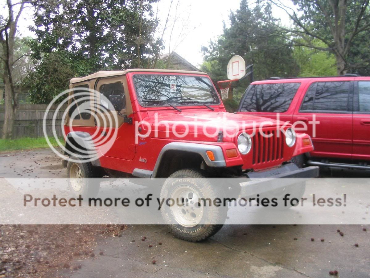

i put on a 2in ch budget boost and a 2 inch body lift
before pic
after
i have 30's on now. i figure 33's will give me another few inches of boost also
