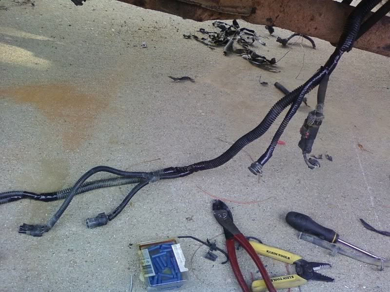

few pics, will get more

post #51 of 173 Old 09-27-2008, 01:37 PM
dodgetk81
Join Date: Mar 2004
Location: PA
Posts: 586
What harness are you using? If its a tj harness, it should just plug in and work. You may have had to change some sensors, but thats it.

post #52 of 173 Old 09-27-2008, 01:38 PM Thread Starter
RnEmOvr
Have Cummins, Will tow.
RnEmOvr's Avatar
Join Date: Mar 2005
Location: El Paso
Posts: 12,059
its a TJ harness but mine has the rectangle plugs at top center as where this once has 2 square ones over by battery

post #53 of 173 Old 09-27-2008, 04:51 PM
Dmax5er
Location: Ar
Posts: 362
GEEEEZZZ!!! looks like spaghetti,, ill stick to body work.........

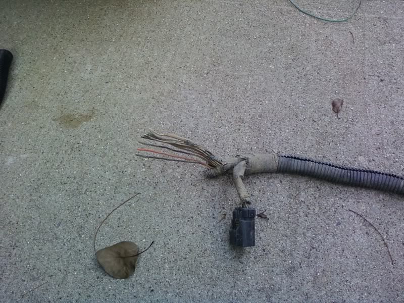

post #55 of 173 Old 10-01-2008, 07:04 PM Thread Starter
RnEmOvr
RnEmOvr's Avatar
Join Date: Mar 2005
Location: El Paso
Posts: 12,059
well finished up the harness, started with what you see sitting on the tire in above pics, then to this
then finished up with this, (from first plug back was cut off)
