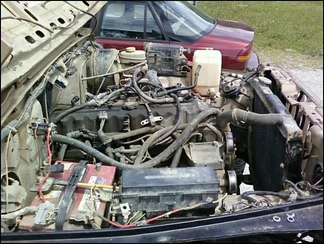

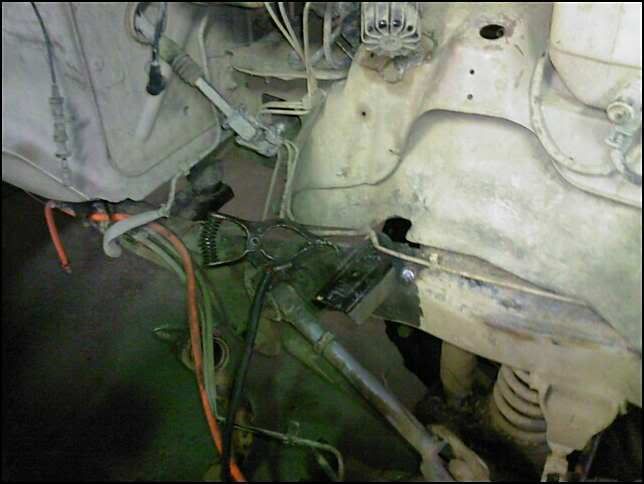

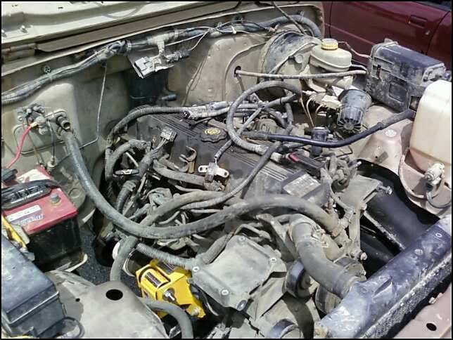

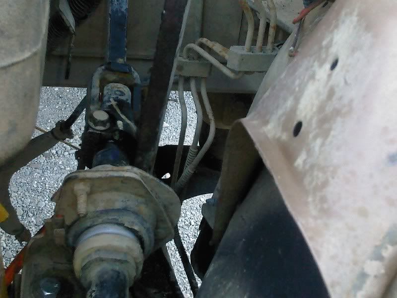

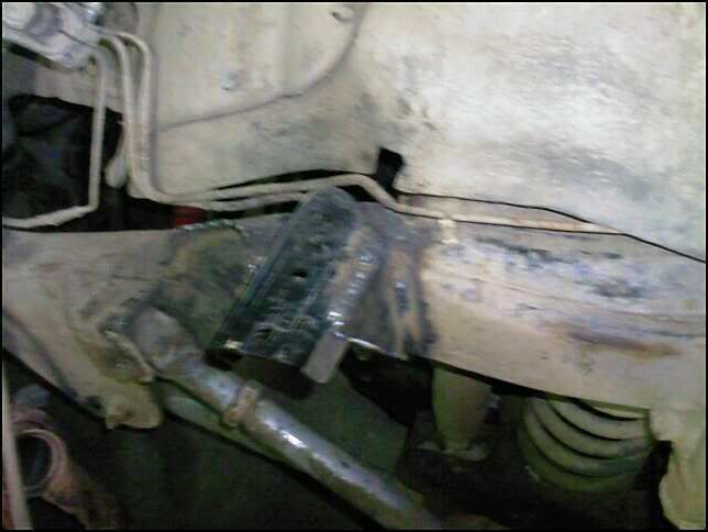

finally stole the ex GFs phone and uploaded the pics here you go, sorry they quality isn't that good its from a camera phone
cut old mounts off, gotta love plasma cutters!!
all gone

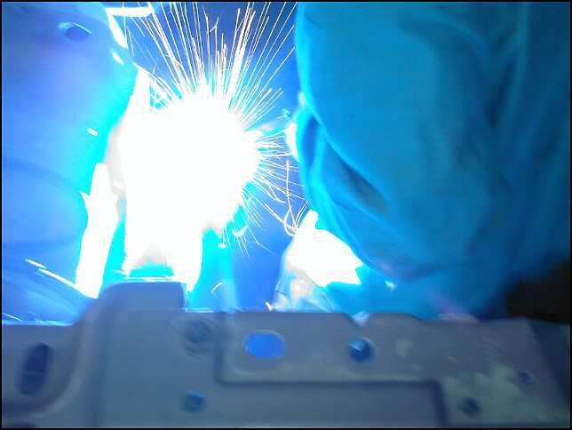

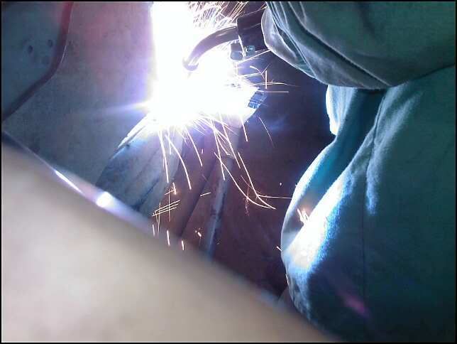

well remember my engine hoist? well it wouldn't work due to bumper sticking out so far, so instead of taking bumper off, we pulled out dads F550 work truck with hoist
getting motor in place
checking for clearance

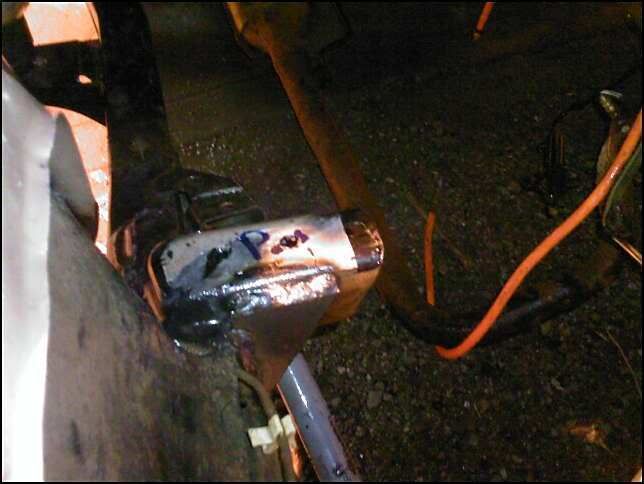

we then marked mounts, pulled motor, tacked mounts and tested motor again, mounts were to far back,
so moved them up little bit and tried again

Posts: 12,055

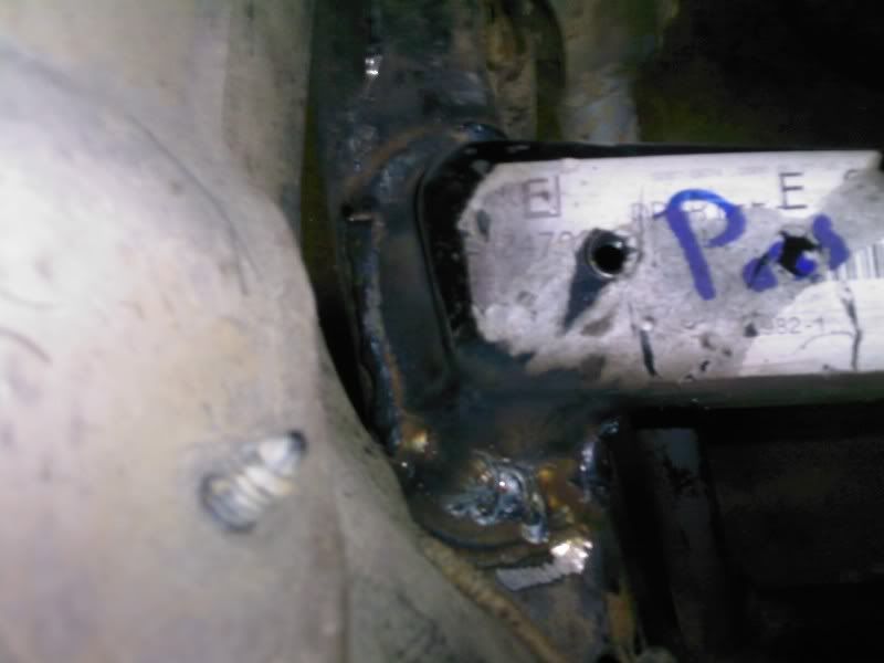

they fit so dad fully burnt them in
his welds are getting better, i dont think these are going anywhere, but just to be on safe side be are making braces this week,

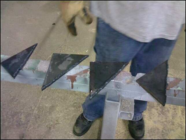

finished the mount supports, the ex GF even helped again
all cut out,
cleaning them up some
welding them in,
all done, motor going in tomorrow

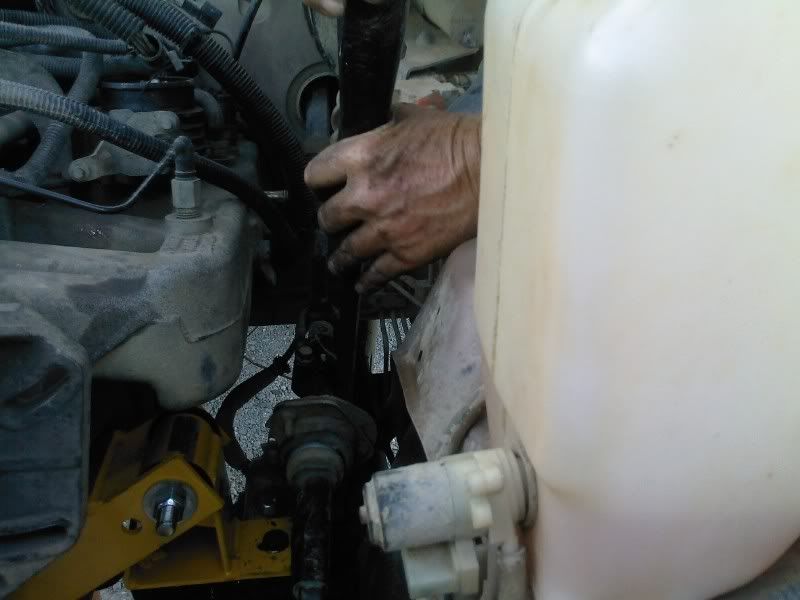

well i got the motor and trans bolted in today, but got so excited i forgot to get pics, i will get them tomorrow, but here is pics of us redoing the steering bracket

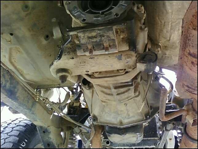

post #28 of 172 Old 07-25-2008, 12:05 AM Thread Starter
RnEmOvr
Have Cummins, Will tow.
RnEmOvr's Avatar
Join Date: Mar 2005
Location: El Paso
Posts: 12,055
motor is in!!! will start wiring tomorrow
new brown dog MML and engine side mounts
and trans
RnEmOvr is offline
