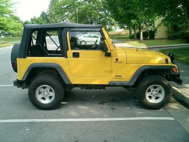

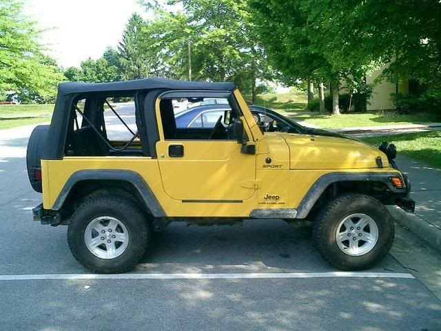

I have the same BB and shocks with a JKS 1.25"BL and 1"BMML. I needed the MML to cure a 30mph vibe after the lift, but with the BL and MML I'm all set to go for a tummy tuck as soon as I finish all the other projects that are either half done or are still in boxes in the garage. Here are some pics of mine with the BB and BL on 31's:
Here is the BB without the BL on 31's:

also...thanks rmb2485 for the pictures, that gives me a great idea of how mine will look. much appreciated!
