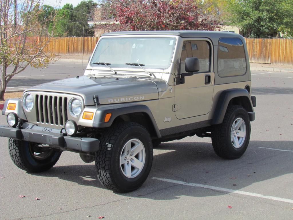

I put a Zone Offroad 2" BB with shocks. I really like it with my 31" tires. If I go up to 33s, I will do a MM & 1.25" body lift.
Below is a 2006 Rubi I previously had with a 2" BB & 32" tires:
[IMG][/IMG]
