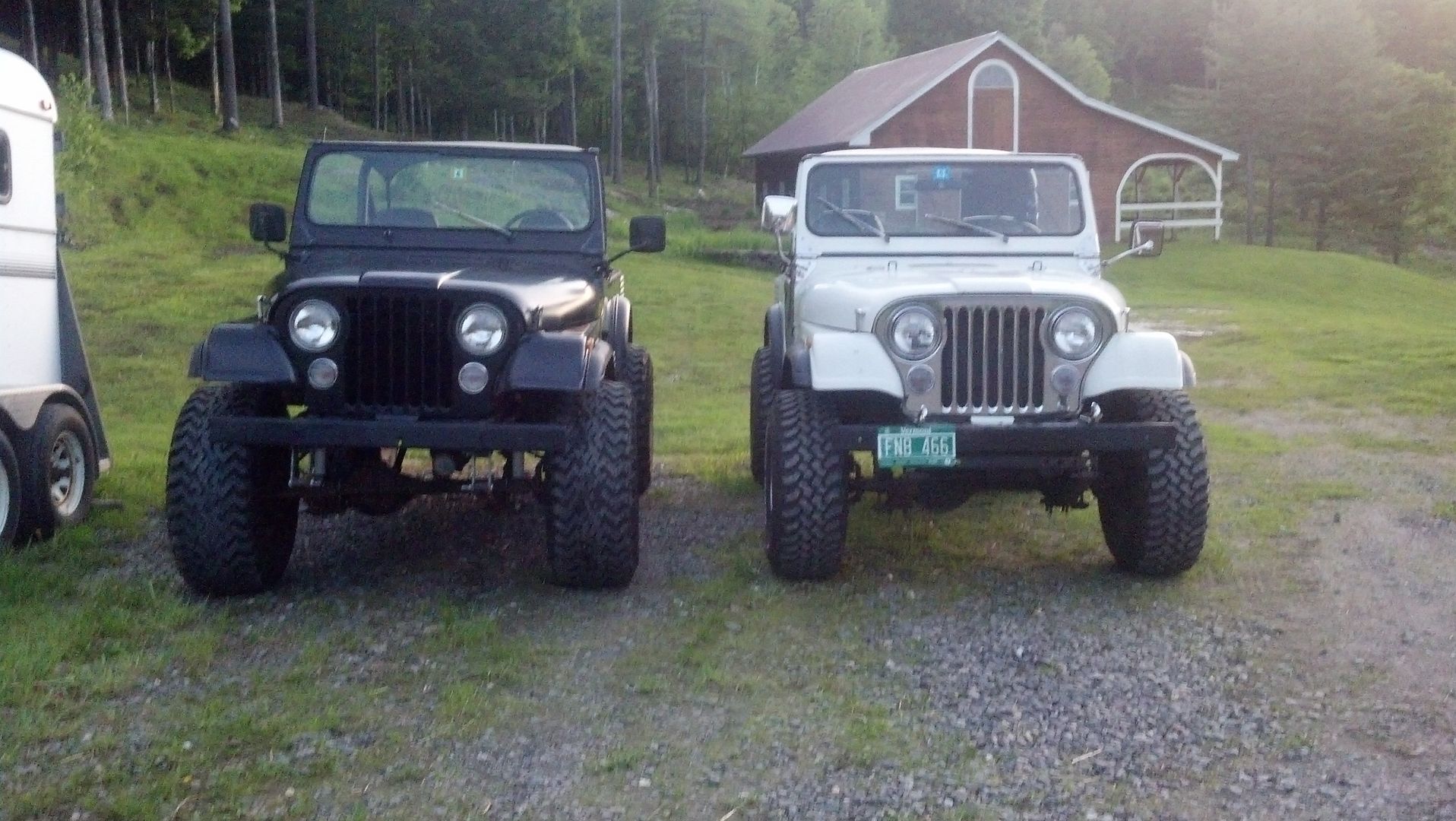

I also have stupid awful autozone shackles on it right now that are way to long. They were all I access to when I threw the jeep together last year knowing I was going to upgrade stuff this winter.
This shows the clearence. Granted someone cut the rear wheel wells a little bigger for TJ flares since it was a YJ tub but I have a better tub going on it this winter thats mint to get rid of all the silly diamond plate.
