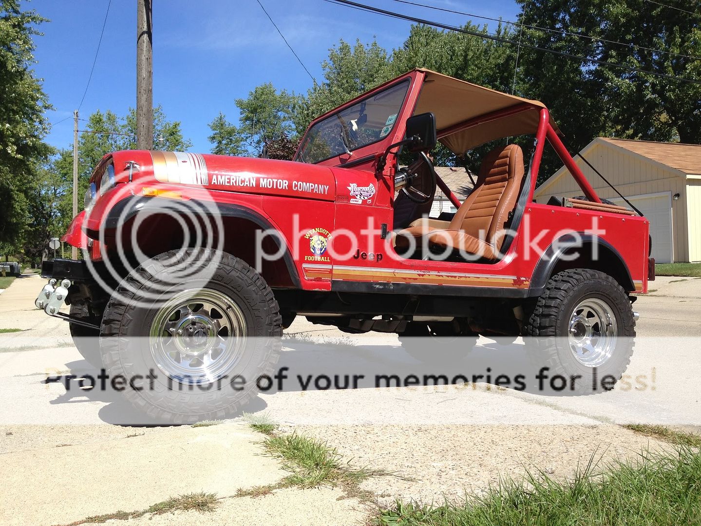

The problem was, the sleeve I had for the R.E. greesable shackles would not fit OME's 1.25" bushings. I had springs mounted correctly to fixed end but could not get shackle end correct without a different sleeve. Does anyone think this will be a problem?

Got shackles all greased up and been driving around all morning. I think I lost some castor, hard to read using the top ball joint nut..cant get my fat head in there. Any other place to check from? from what I could see it dropped to around 3 degree's. Front is now sitting slightly higher then rear but I still haven't mounted my front bumper and winch yet.

Are the shackle length, bolt hole to bolt hole, the same for the front and rear? The front looks good but the back looks low. I don't think another 100-120# of winch and bumper is enough to even it out.

Great idea for checking castor I'll do that for sure thanks! I only replaced fronts and yes, it's about a 1" higher then rear. Next year I'll do the rear and level it out. Rear is still stock springs with lift shackles . I'm very pleased with fronts but I will need shims for sure now that they've settled a bit. I also need to flop drag link to flatten that out too.
